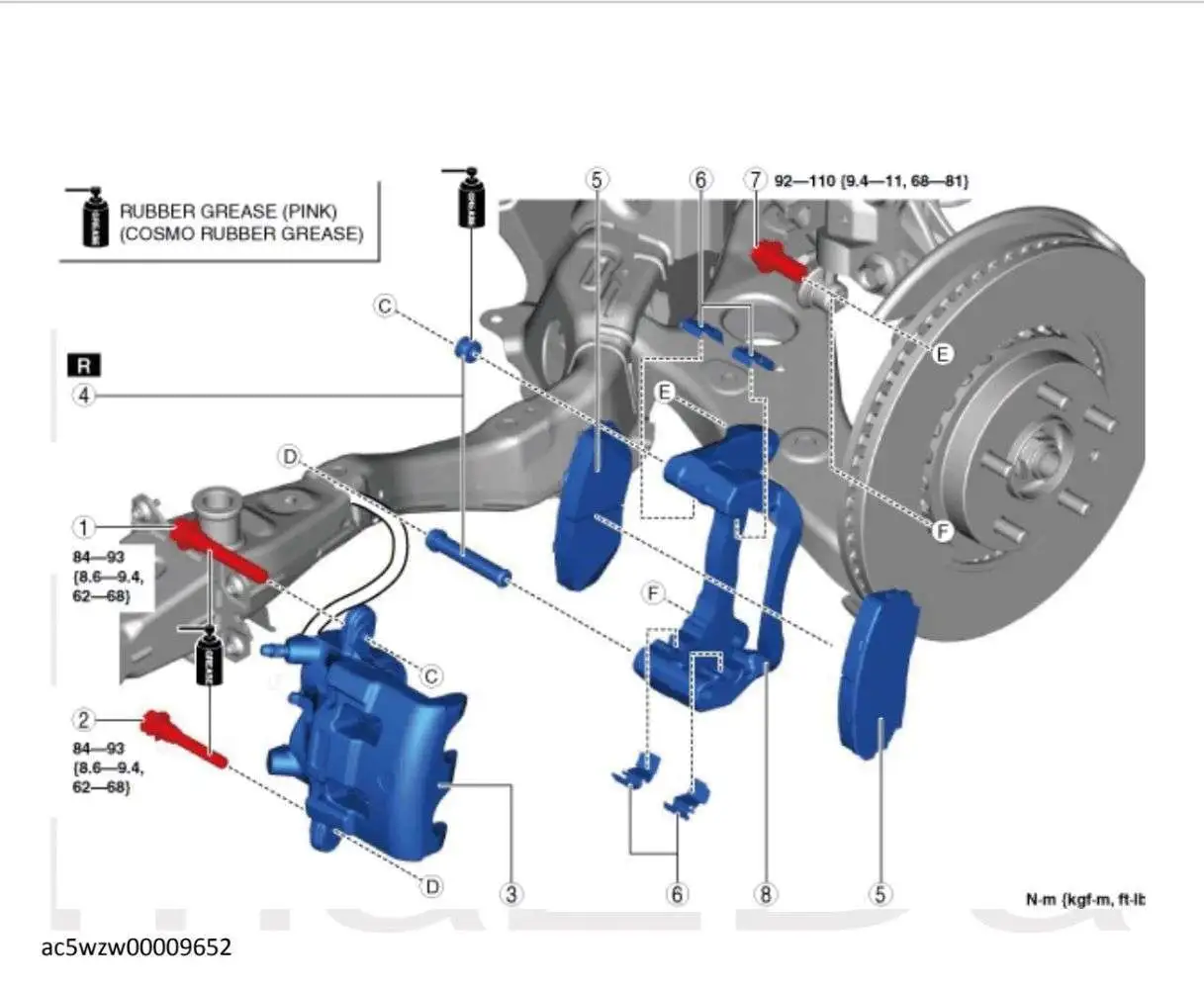

Banjo bolt gets torqued at 21 ft lbs. Drawings show two gaskets get used, one on each side but mine only had one when I replaced the brake hose.

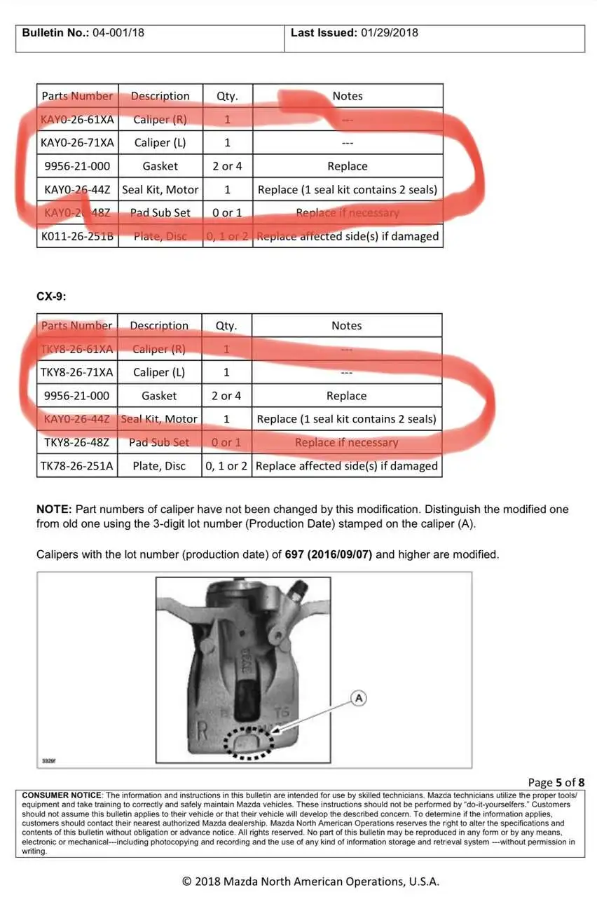

Here is a TSB to replace the rear disc brake calipers for dragging issue:
TSB No. 04-001/18: Noise from Rear Brakes Due to Brake Dragging

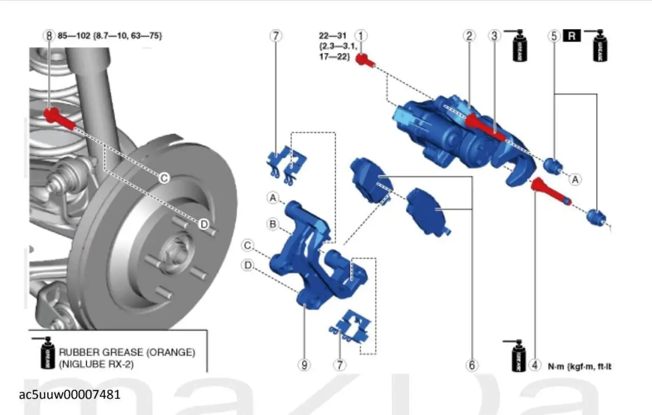

These 2 copper “gaskets”, p/n: 9956-21-000, always need to be replaced when you replace the caliper. It does show 2 gaskets (D) for each caliper.
Torque values:
