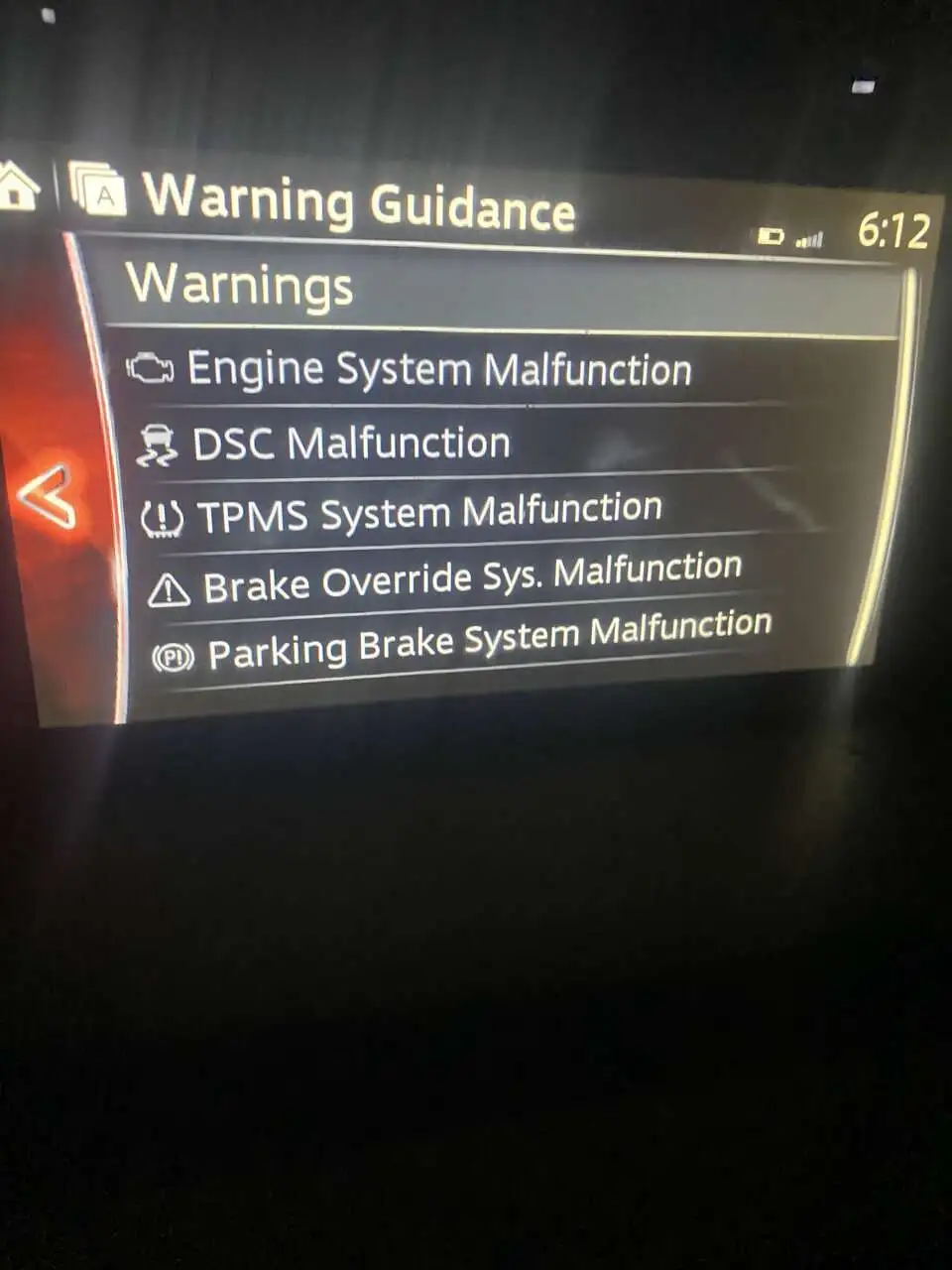

I had my car in the shop to address a tire with a leak. After getting my car back that evening every warning light related to the tires came on and my break lights were on the entire time. I notified the shop and they told me to bring it back in. They ran diagnostics and said it was the brake switch and not related to the tire repair. I had no issues prior. I brought it back and they replaced the switch for the third time since the first one failed during the first replacement. Then wanted to charge me more for more diagnostics saying it was electrical and preexisting to the the tire repair. Reading a lot of similar has anyone found a fix? I don’t want to spend a fortune looking for a gremlin but also I can’t safely drive my car when the break lights are constantly on. 2016 Cx5 100k miles. Battery a year old. All fluids are topped off :)
My first thought would be battery but unlikely if it's only 1 yr old. Could you take a picture of the lights?
I even disconnected the battery for 15 20 minutes to see if it would reset and the brake lights are still on and then the warning lights have gone down to two left the traction control lights malfunction and the tire pressure sensor light says it’s malfunctioned.

New development. Warning lights and break lights turn off when I turn them off. Come back on when I turn lights on.
Did you take a look to see if they damaged an ABS sensor wire? Maybe one got ripped and is shorting on something. Also, it's possible the battery could be bad even though it's new. But it sounds like some one did something underneath.
