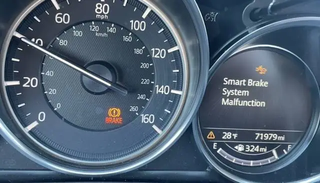

The Smart Brake System Malfunction light came on first. It went on after I parked, shut the car off & turned it back on. A few hours later on the way home that warning came back on with a low brake fluid warning in the infotainment screen warning guidance & Front Radar Sensor System Malfunction. It also said Smart Brake System Malfunction.
I’m thinking it’s a combo of worn pads and low brake fluid. It just struck me as odd that the radar system warning would come on with the other ones. It was especially cold at 9° or so. The radar light came back on after a car wash so I know it wasn’t road grime/salt causing that.
