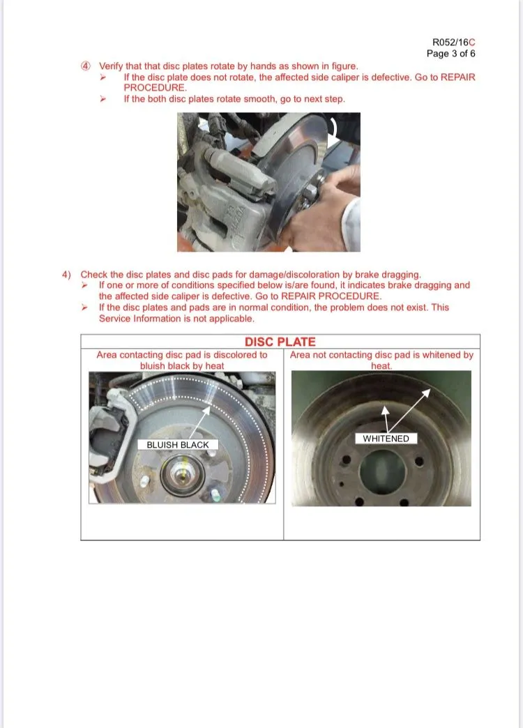

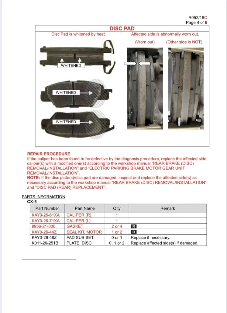

And there’s a brand new TSB 04-007/20 which covers all CX-5’s from 2016 MY to 2020 with EPB.
Click the upper arrow next to the poster name Hawke at the beginning of his post which I enclosed in my post, it’ll take you to his original post with his TSB document attached. Yes the TSB does list the part number for new harder rear disk pads, although the original pads seem still available for sale. I believe this’s only the problem on OEM disk pads, at least for rear, for those areas with rust problem due to road salt.Does it mention new part number for the brake pads?

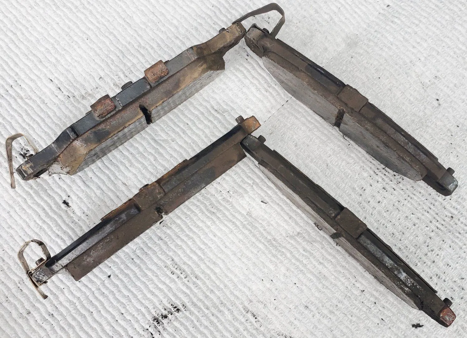

You need a pair of new rear disk calipers based on the wear condition of inner and outer pads. In addition to uneven wear you’ll keep getting between inner and outer pads, you’ll also have possibility of rear disk locked up while you’re driving on the highway. See the 2nd scenario of pad condition in the TSB:This is what I took out
This is my first ever experience taking brake pads out, so I'm really interested in understanding if a) this wear on 13k pads and b) inside pads wear 3x vs outer ones is an indication of a defect or it might be normal? Common sense tells me it's not normal, what could explain that?
