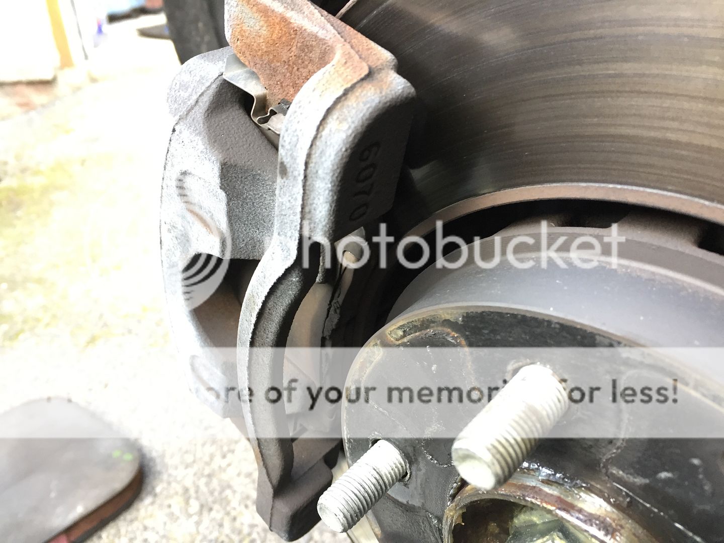

I changed the wheels back to the original 19 inch summers and used the opportunity to clean up the calipers which after 12 months and 12000 miles were looking quite poor.
Brake pipe clamped, caliper off and then the carrier, all the parts including pads, shims and carrier clips all cleaned. Following reports on here that the guide pins were not properly lubricated, they were stripped out too. Well mine were well greased and like new pins!

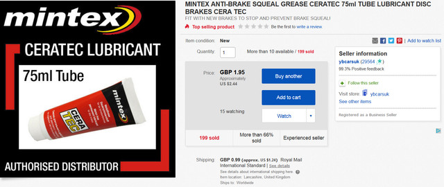

I had new pads on stand by but mine were 6mm and the new ones 9.5mm. They were made by Ferodo in my home town and have made their way to Hiroshima for building on to my CX-5! I checked all the edges for lift, cleaned out the groove and assembled the shims with clean ceratec grease.

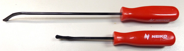

I used a small pick to carefully let the air out.

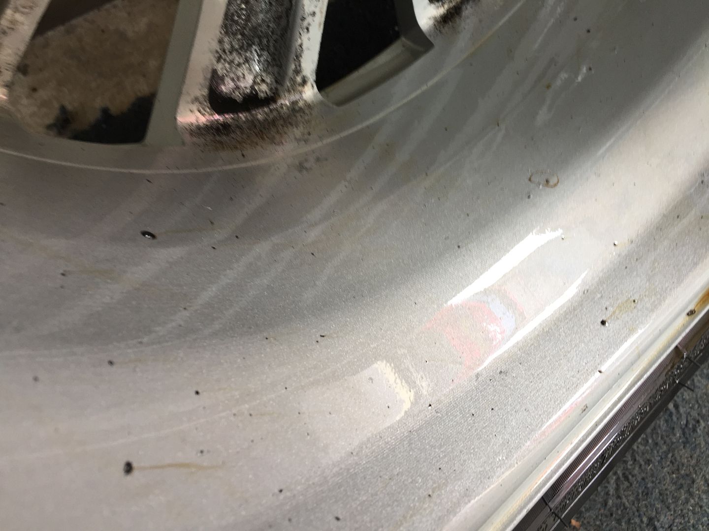

After much cleaning and wire brushing, the parts were dried in the obvious place,

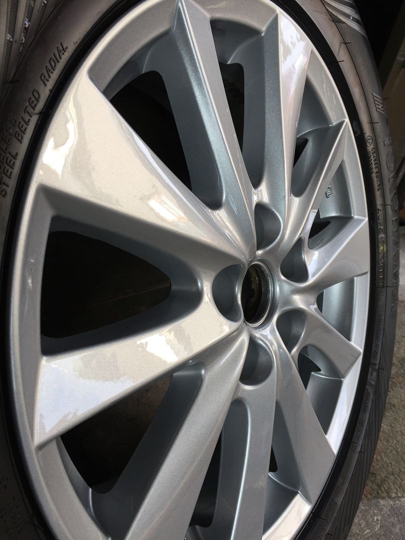

Eventually with the wheel fitted, it looks a treat,
