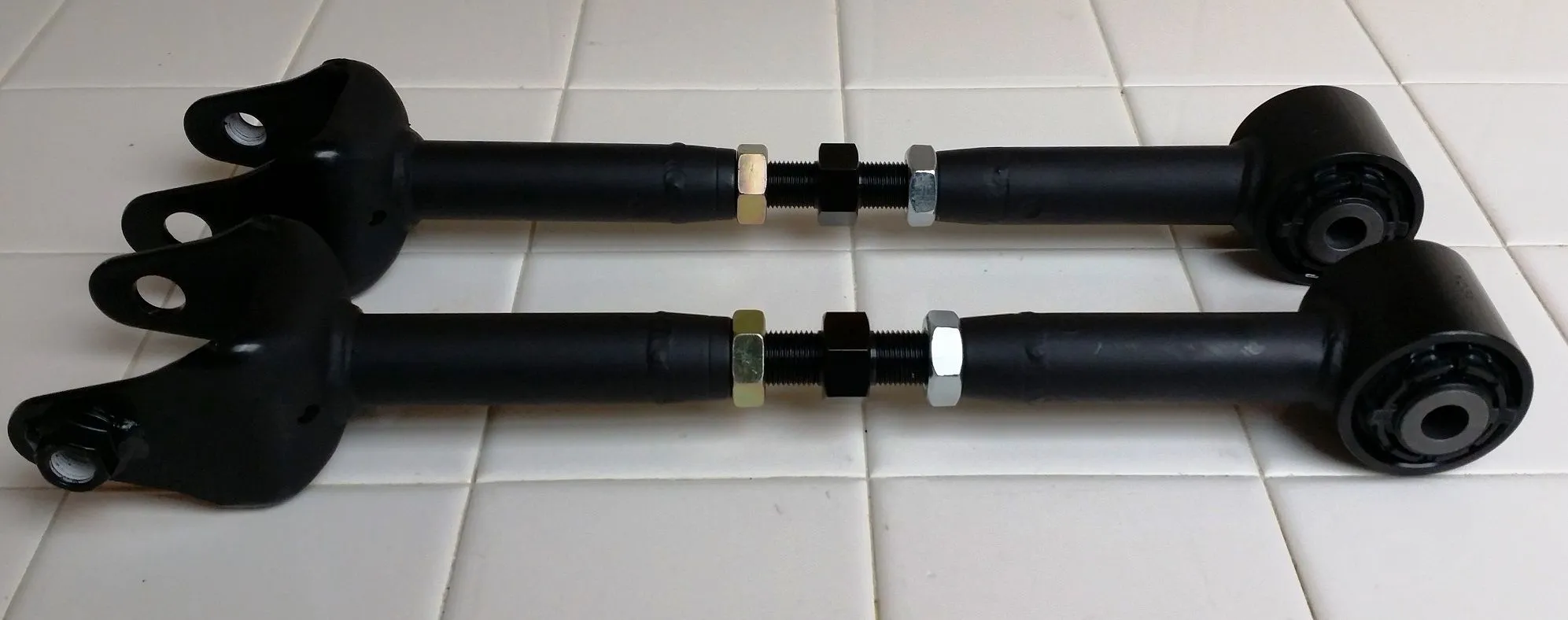

I made my own lateral links adjustable and trying to adjust the eccentric bolt with it, to adjust camber.
I don't know the outcome, of how many degrees I can adjust, but I'm willing to gamble here and find out. Even if I can reduce it only 1 degree, it's still better, then just leaving it this way.

I put the jbr arm to the cx 5 arm (hung it on the part of the bolt sticking out). The result was 40mm, from the end of the arm to the top of the locking nut. I'm not sure what (which point on the arm) maz was referring to when he said it was extended 35mm, because from the end 35mm seems way to long. As is there is less than 1" of thread when matched. Maybe a 1" extension would be more appropiate. In the pic the bottom arm represents the oem reach. I'll have to find my alignment.

looks like I only need like 1 or 1.5" of additional length to fix rear camber (and once the coils are on i'm looking at different #'s anyhow), and the bolt should still be able to go into the bar
The amount of inches is not equal to the number in degrees. Also, just because an angle is within factory specs doesn't mean tires won't wear unevenly. Keep in mind, manufacturers want handling numbers, they don't care much if you get 100% life of your tread. From my experience, I saw no tire wear from angles of 1 or less on camber and numbers closest to 0 in toe.
Well , I would like to have my rears to be more precise and less random, maybe -1. It's possible the mz6 arm may work as is, since adding - camber would mean make it shorter (more threads inside). I'll have to see what kind of rough camber # I get after I install the bc coilover at a height I want. I bought one of those camber gauge.
-1 would be great to have from a tire wear aspect. How that affects the way you drive may be a different matter. High performance and race have excessive negative camber & toe for better cornering at the expense of tire life. Another aspect many alignment "technicians" don't consider is the alignment readings with the weight of people and luggage in the car. Whenever I did a custom alignment for a race car or a picky customer I would have him in the car along with a full tank of gas while doing an alignment. On most cars, the left cambers will get more positive while the right cambers got more negative with the weight . German and Italian manufacturers recommend sand bag weights when doing their alignments.
My own lateral links still work great. Some were trying to talk me out of them. See top of this page.
