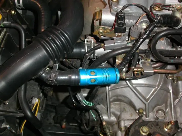

FWIW, I have a TurboXS Type-S BOV attached to stock piping. I get one hell of a racket from the BOV... very turkey-like, but with a killer howl. I don't think that I'm getting one bit of compressor surge, either. The BOV is set very sensitive, and will release with even the lightest throttle application and lift. I think my turkey comes from the plastic pipes. Flexible materials don't always release pressure smoothly. Sometimes the material oscillates on release, which is where I think the noise comes from. There's no way I'm getting any surge when the BOV releases so easily. I'll see if I can dig up a pic of how my Type-S is attached...
*edit* And I have to try pretty hard to get it to stall. This setup was actually like this when I bought the car with 8k miles, and I've never screwed with it except to clean the BOV. Obviously things will change when I install the Ion FMIC and get the new engine in. I still plan on running this BOV though, hopefully it can handle the flow from a Gt25/28 hybrid.
