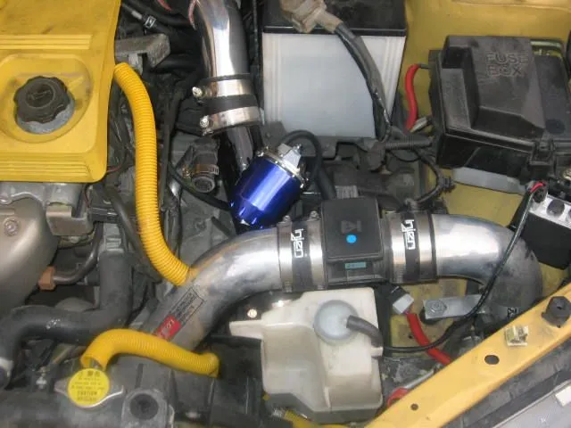

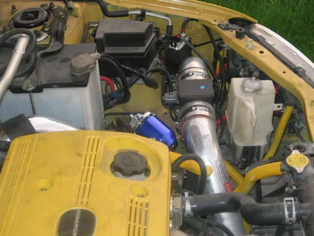

Well here is my setup, I hope this will help !!

ok, you def are not recirculating so I don't think the air is going back into the intake pipe. Do you mean it isn't coming out of the BOV at all, so it is just going back into the cold pipe? That is bad if that is the case. Maybe the BOV isn't seeing the vac that it needs to function properly? is there more than one nipple on the BOV? Some BOVs have a pressure nipple and vacuum nipple. If yours has two switch them and see if that helps. Otherwise you need to play around with the tuning on the BOV and hope that that thing isn't shot.
Yea thats it, it goes back to the cold pipe. There is only one nipple on this one. When you say I have to play with the tunning, I dont know what I have to do man...Is there a simple way to fix that problem ??

there is a bolt on teh top that can be tightened or loosened, you are gonna have to play around with that until you get rid of turkey and stalling issues. I'd suggest going as loose as possible while still having the bolt in and then drive for a touch, take your tools with you, if problem persists then tighten it down a touch and drive further, keep going until you get waht you want out of it. I know the Greddys adjust this way, Blitz and APEXi as well. TurboXS requires you to remove the top exposing the spring and drop washers into it changing the stiffness of the spring. i am not too sure how to adjust the HKS ut it looiks like there is a adjusting bolt on teh end of that in your picture.
where does your bov get its vac source from? have you checked to see if it is still intact and searched the line for cracks?
