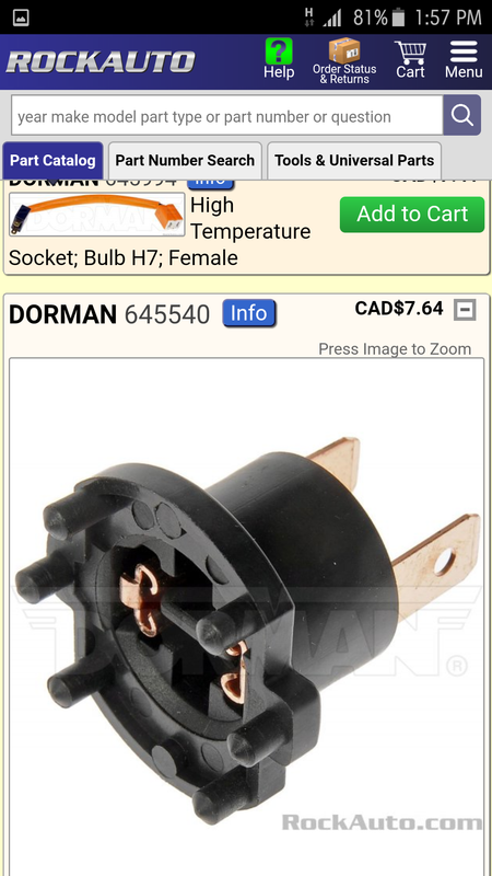

There is also confusion (for me) regarding the bulb type. Some bulb ID sources have been incorrect in the past, and I made a note that the low beam bulb is an H7. Can anyone verify that?

You're correct, low beams for a P5 are H7.
The Protege sedan has a different headlight housing with a single bulb for the hi and lo beam.
That could be the source of the confusion.
Some guys have put the sedan housing on their P5's because they got tired of bulbs burning out.
There is an adaptor on the low beam bulb for the P5 that likes to get all burnt and crispy.
It can help to replace it.

Aha - yes, that pesky adapter. I remember the first time I returned bulbs that "wouldn't fit", and the counter guy told me about the adapter. I made a note of that in her little notebook. Seems I should go ahead and replace those. Just prior to or after replacing her bulbs the last time, one bulb was going on/off as she was driving, and I recall wiggling the connector. It started working again then. That could be the cause of this whole issue. I will buy 2 new adapters now - thanks.
I remember throwing my bulbs in the garbage can at the auto store parking lot, along with the adapters. I had to fish them out of the garbage. lol
PS. Some Dielectric grease on the terminals can help a lot.

From post #11 above, I ordered new adapters, as well as bulbs ($3 for the bulbs, vs $14 Walmart Sylvanias) from RockAuto. I figured I would just replace the adapters as a precaution (or it may even be a cure). While I am in there, I will pay attention to the security of the wire bulb clips. If, after installing new bulbs, the bulbs or wire clips are loose, then I will make an adjustment to secure them. Maybe bend the clip wires a little, to get rid of a rattle.

When the new adapters and $3 bulbs from RockAuto get here, I will replace the adapters, give her the 2 bulbs to carry in her car as spares, and show her how to pull the bulbs out. If/when the bulbs burn out again, then she can just replace them herself, maybe even right then and there. Hopefully the old adapters contributed to the problem and the new ones may help these new bulbs last longer, though. But I don't really expect they will last more than 6 months or so, like the last ones did.
