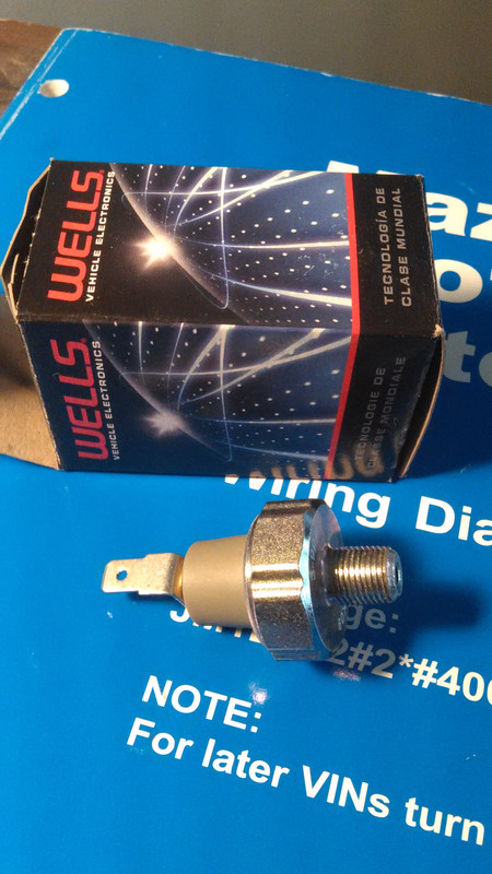

if it's well taken care for and in good shape, boost the stock engine. install an oil pressure gauge beforehand to see where it stands and get someone to do a compression test.
I just ordered a compression tester. How hard is it to install an oil pressure gauge?

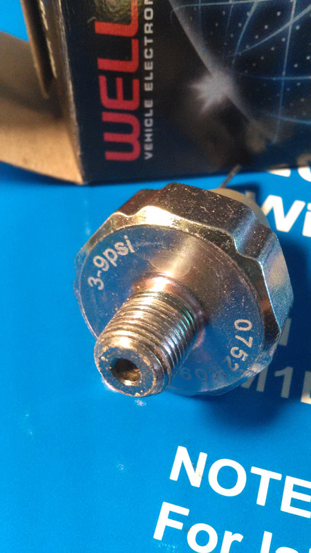

... from what I hear, the stock one doesn't trigger the oil light on the dash until it hits 5psi or something low like that. basically too late by the time you see the light.
