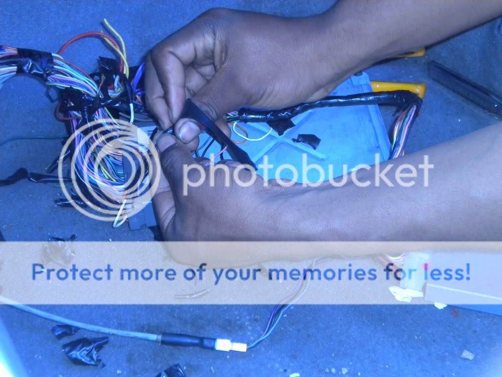

update!!! tomorrow i will FINALLY be putting the MPI piggback back onto the car and turn the boost up to 12-13psi n tune.. hopefully i'll get some pixs maybe even a lil vid of the tune
Damn man y u wana jinx me lol naw i shud b good hell i use to run 14.5psi then i jist decided to turn it down... wosh me luck lol

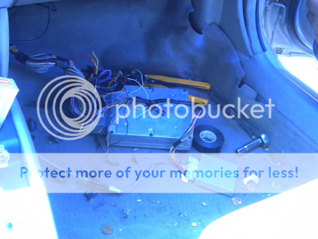

MPI is now installed n is pushin 12-13psi nice n strong :)
it was hella easy to install since we already had the wire colors splice into the harness wires lol so install wass sayy 20mins??
tune was pretty easy since i still had my last map from when i was runnin 12psi jist hada tweek it alil n wow it feels nice spikes at 13psi and afr stay at 12.8 will attach the map for others to use as a base map

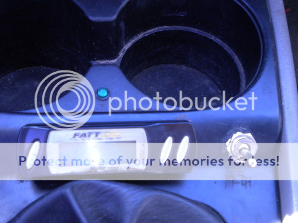

im runnin mine to a switch,, but the pressure switch is set to come on a 11ps
what i also like about the kit is the green led thats lets u kno when the meth is being injected. also have the red led for low fluid sensor but didn't install ass of yet
