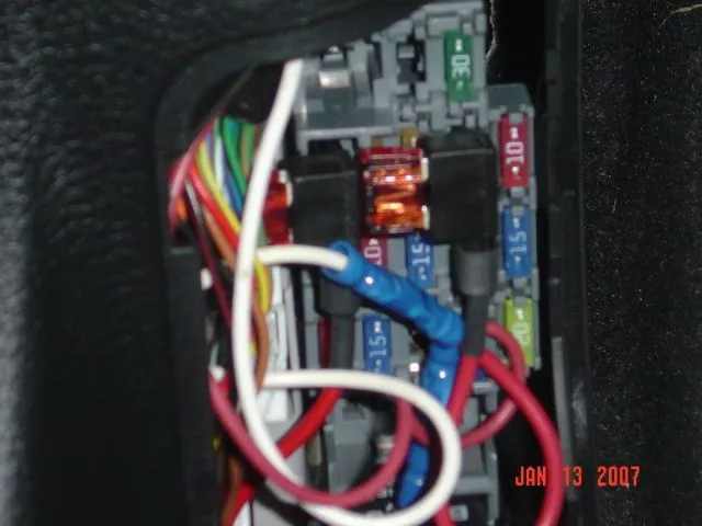

where did you tap your wires into?
I tapped into both of the cig. 15amps fuses.
mrmister said:
Do you happen to have a picture of where you hooked into for electric.
Thanks.
I used two fuse splitters in the cig locations.
I am using the VEI gauge so I do not use the dim feature. I ran the power 12v wire to one and ran the wire for lights to the other cig fuse.
