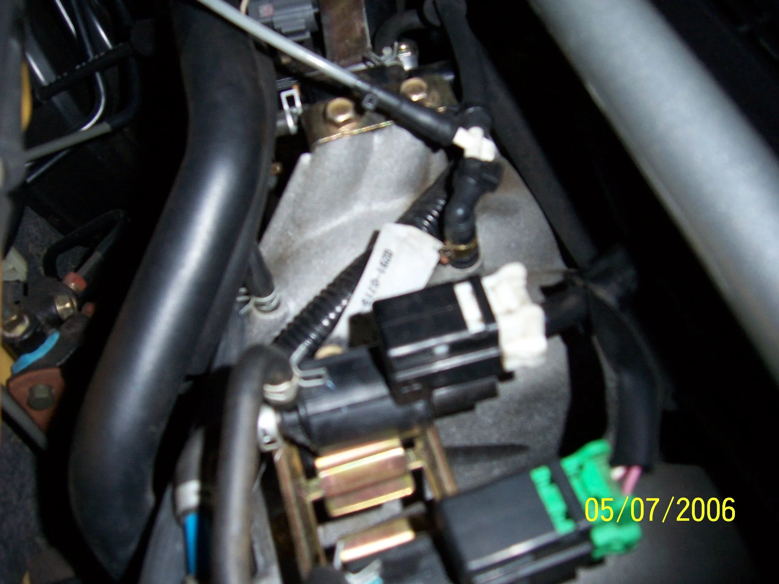

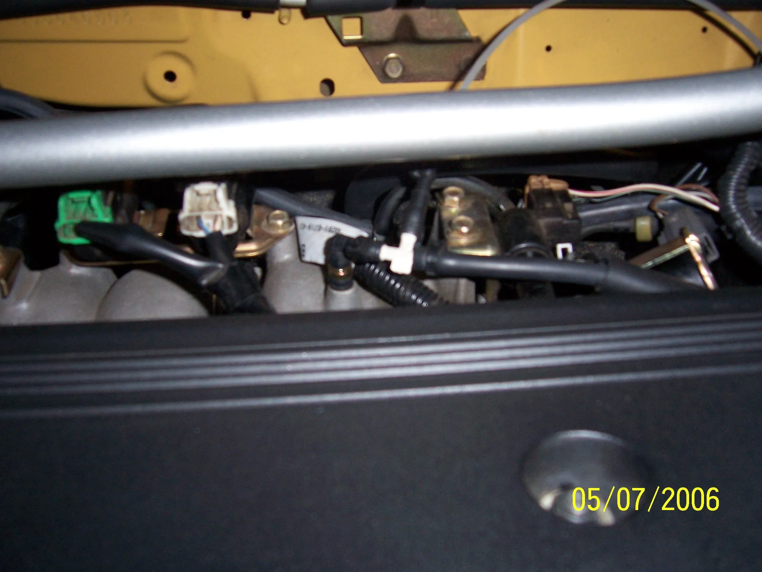

Using the brake booster may be better (I really don't know), but this has worked fine for me.
Look at the white t-fitting. That is where I have it tapped.

dirtysouth_msp said:
My bad, BPV = By Pass Valve & WGA = Wastegate Actuator.
Wow,
thanks for the pic's and that helps so much better when you can see it.
