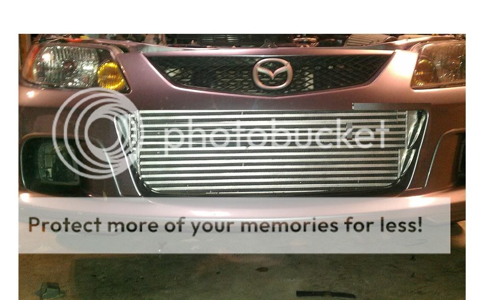

im heading to certifit while im out and about tommorow and picking up a front bumper cover for a couple $ and going to modify the front lower grill so its much taller i choped a pic in ms paint real quick to give a idea of what im talking about becuase i have about 8in of intercooler hidden behind that bumper cover migh aswell bust out the dremel and files and fiberglass and make a custom front bumper cover to put that big cooler to use anyhow choppy image here i come
to this vvvvvv
I think that looks a bit wacky, and somewhat ridiculous. That IC is HUGE, hopefully not too big. If your windshield washers don't work try new Tribute nozzles, that fixed mine.
Looks great so far! Keep up the good work!
As for the IC, Leave the bumper alone IMO. The middle hole in the bumper is a good enough size to support the air flow. The natural look of the front cover has a great design, and style to it. I just don't want you to ruin the precious face of the car. I think it's the greatest part of the car IMO. In this case, functionality over form doesn't really apply.
So what size turbo are you going to use when you go forged? With an intercooler that size, you may as well slap on a GT35R and crank it to 30+ psi.

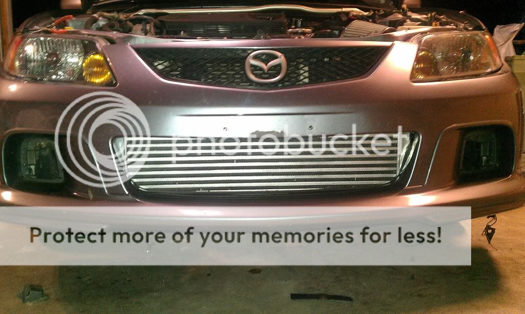

another pic of the intercooler installed
well i know noone was a fan of the idea but i still wanted to take the time and chop the image to get a better idea of what it would look like anyhow ill post it anyways

Nice install. I hope you are running much more than stock boost, that HUGE IC core is gonna need it.
