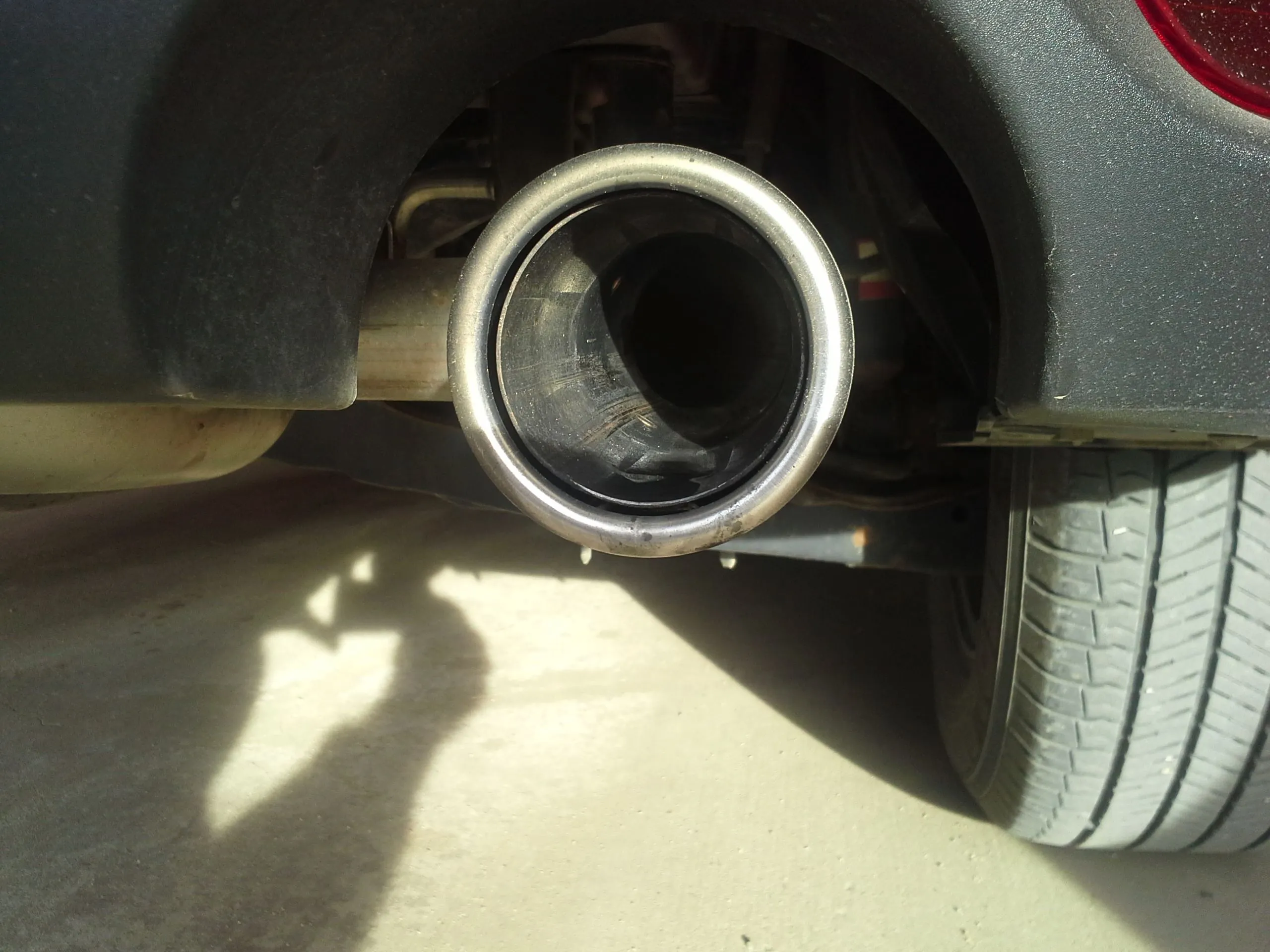

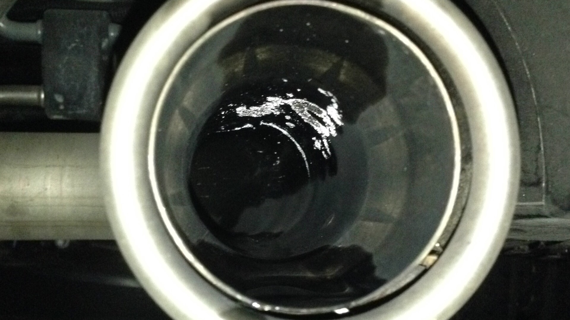

The exhaust tips of my 4 month old 2016 CX-5 is blackened with soot and looks like this. My finger gets black when I wipe it.

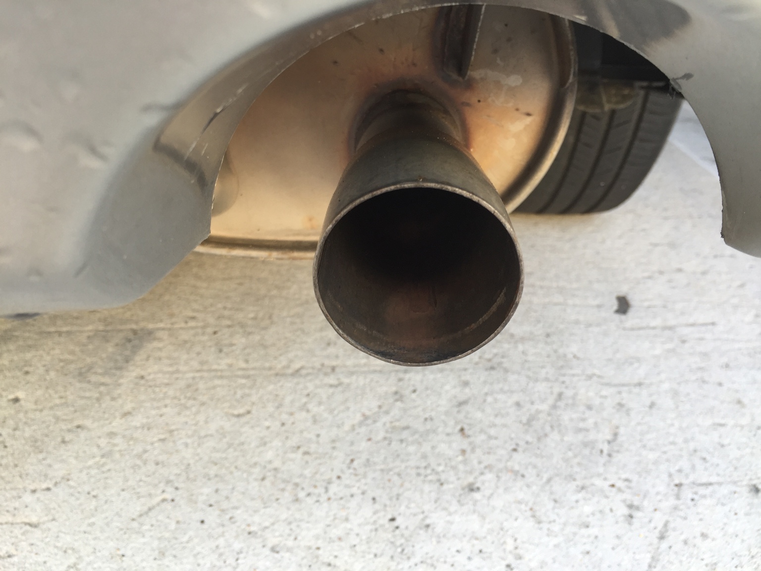

Don't have this problem in my 2005 Lancer. This car is 10 years old, 125k miles and the tips look clean (except for some rust) like this. No black soot. My fingers don't get black when I wipe it.

Is this typical for CX-5? If not, what's going on and what can I do fix it? Is this because the engine might be burning oil?

This is normal and because of the way the exhaust system works. It is not oil. http://www.mazda.com/en/innovation/technology/skyactiv/skyactiv-g/
I'm summarizing extensively here. The fuel efficiency is realized in part because of the high compression the engine achieves. High compression normally means knocking however, so they put in different type of exhaust header that keeps hot exhaust gas away from the cylinders.
When the car is first started, the emissions reducing catalyst is too cold for good operation and because of the long exhaust header, would take awhile to heat up. So for a moment the engine runs a different mode, slightly rough, with some unburned carbons. This results in some soot on the exhaust tips. After a few seconds the catalyst is at operating temperature and normal operation resumes.
You may have noticed how the engine sounds quite different after starting on a cold morning. That's the system in action.
The exhaust you are comparing it to is just the pipe with no stainless steel beauty cover. All cars I have seen that have a beauty cover around the actual exhaust pipe have this. It is normal. Just clean it when you wash your car. My gf has a mazda3 and after many years I had to take stainless steel polisher to the beauty tip to completely clean away this black exhaust stuff.
This is not true in my experience. My 2008 Accord EX-L had the steel cover. It looked great till it was totaled this year.

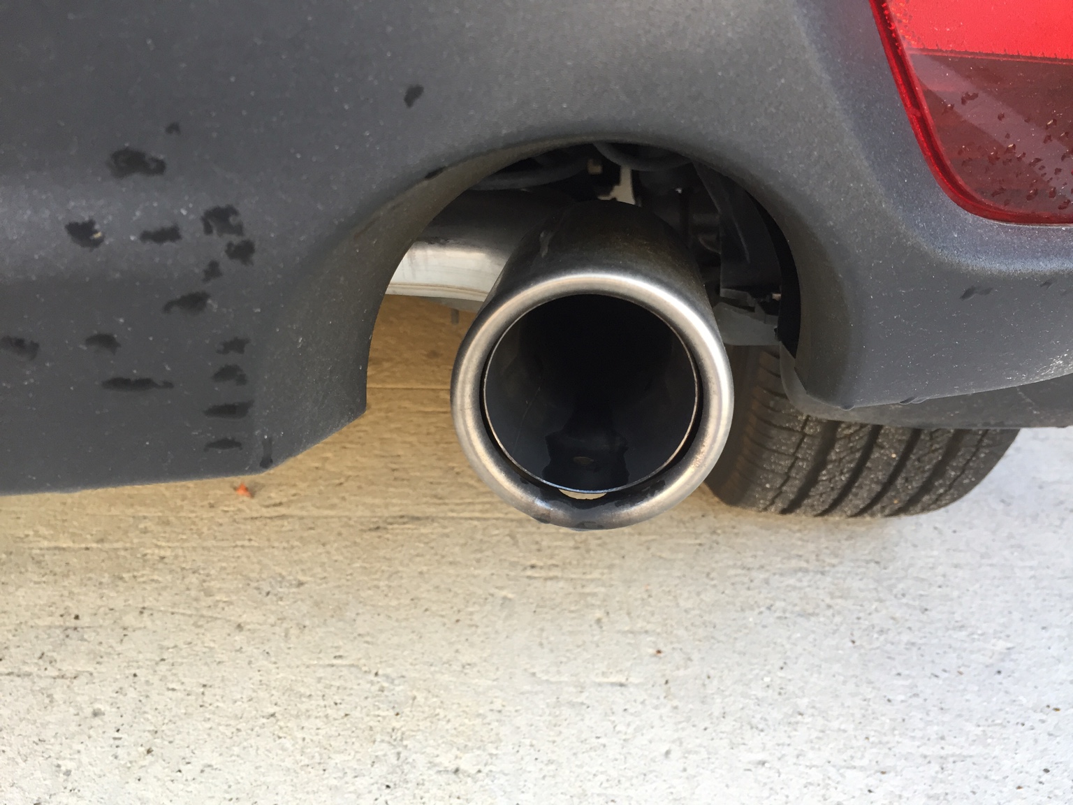

My previous 2014 Mazda 3 had/got the soot, as does my current 2016 CX5. You just have to clean the tips every few weeks or so, unless you don't care how they look.

So what does it mean when the pipe is perfectly clean? From day 1, our '14 always had the black soot around the pipe, a normal thing to wash every week. But the last few months I notice it is no longer there.
I would rather not have the soot, but it's sort of weird that it quit appearing, obviously it's running different, good or bad (uhm)
