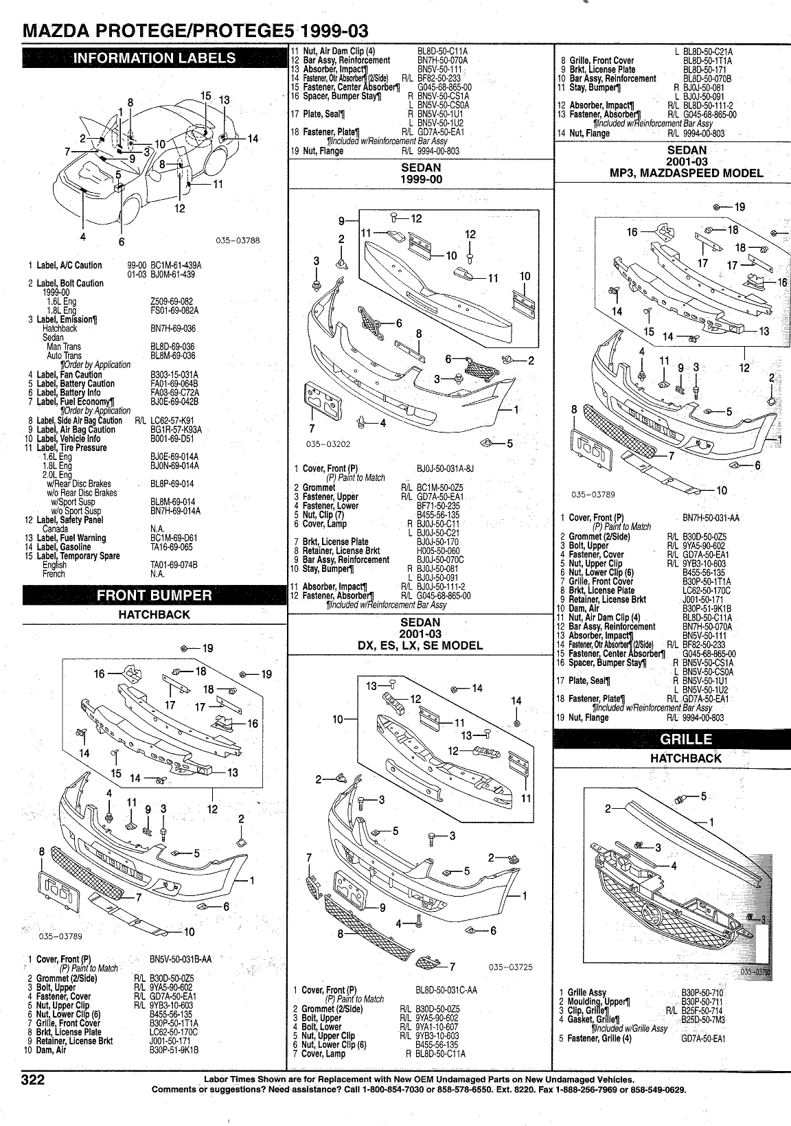

Here's the front bumper removal diagram.

I did this last night to install the blacked out Canadian head lights I bought.
There are 2 screws at the top of the grill, two 10mm bolt under the bumper (behind the black plastic air deflector), and you have to remove 3 or 4 fender liner screw thingys on each side just in front of the wheels in order to get to 2 screws just inside the liners (at about the height of the bottom of the headlights) on both sides. And then there are two more screws (1 each side) underneath the bumper just forward of the wheels to remove. So it's like 16 screws or bolts or fender liner holders that you need to remove in order to get the front bumper off. Once they're removed you should be able to gently finagle the bumper off with out any problem.
Here's an edited list of where I believe all the screws and bolts need to be removed from (scroll down). Sorry if I missed any.
