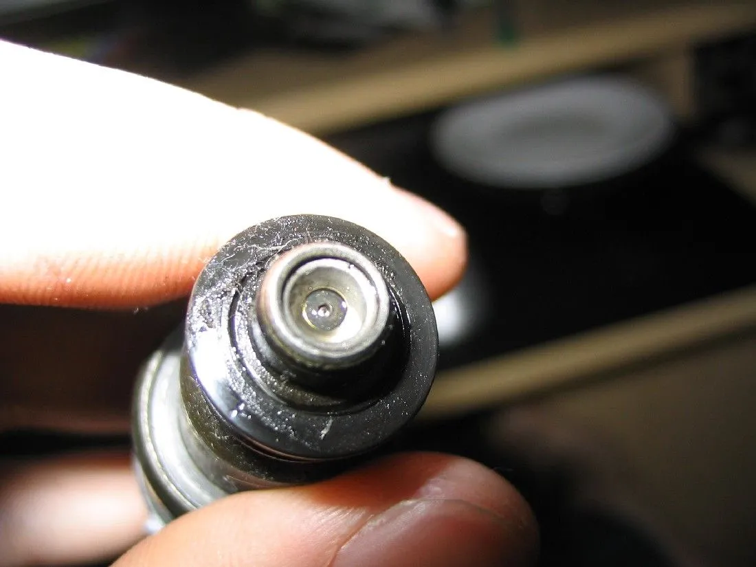

Here is a picture of my primaries... small ball and disc... if you look at my secondary injectors they have little tiny cylinder nozzles that stick out... so very different between the two... I'll maybe get pics of the secondaries soon.
Later.
Steve

I did end up confirming that spacers were used for my fuel rail and injectors. They are about an inch long. The good thing is they are easy parts to order in. So in theory you can easily use the injectors I showed because they fit the rail fine and everything. You just need the spacers and some different bolts. Not direct drop in, but a 15 minute install either way... and at 33 bucks an injector for a 550cc injector... a couple spacers and bolts is a minor inconvenience for that!
Later,
Steve
