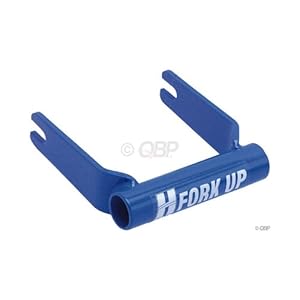

I might be wanting to sell my forklift mounts (Exactly like pictured above). I just bought them in July and they are already cut down so the hatch opens. I just bought a new bike and it has a thru-axle fork :(
Yeah no need to sell they make adaptors like pictured above that work great for what you got!!!
