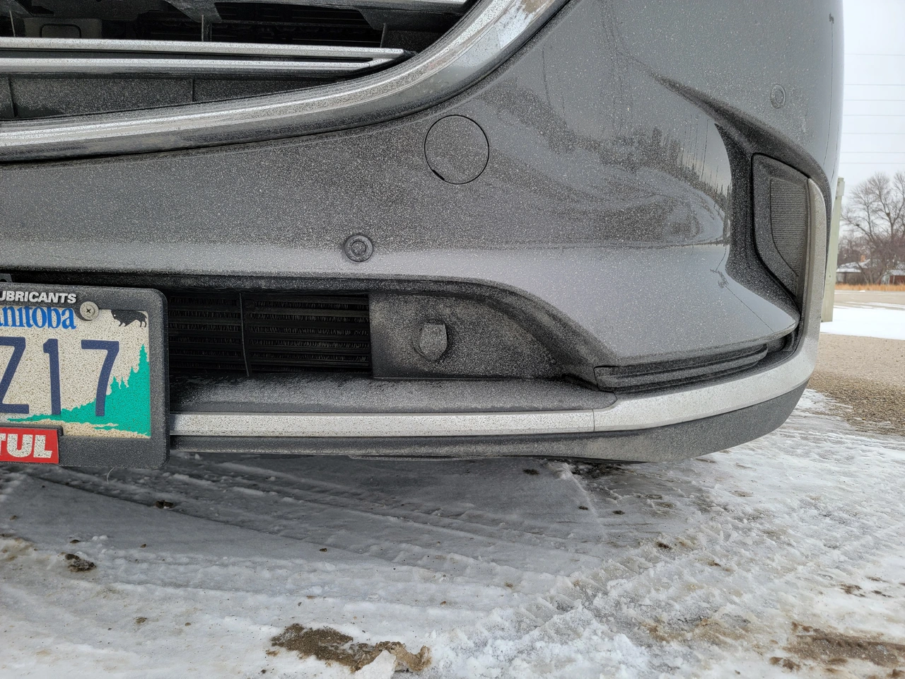

A block heater is a must for me in central Canada. Mine was dealer-installed and made by Temro. I like this one because the block heater cord disconnects at a connector in the lower grille, and when it's not in use, it's covered by a small cap. Really clean installation.

That's clean install. I might look into adding a cap on my 24. If one is OCD, pre heating year round improves FE and engine life. Thanks for the pic! Is that white stuff sand? :ROFLMAO:
