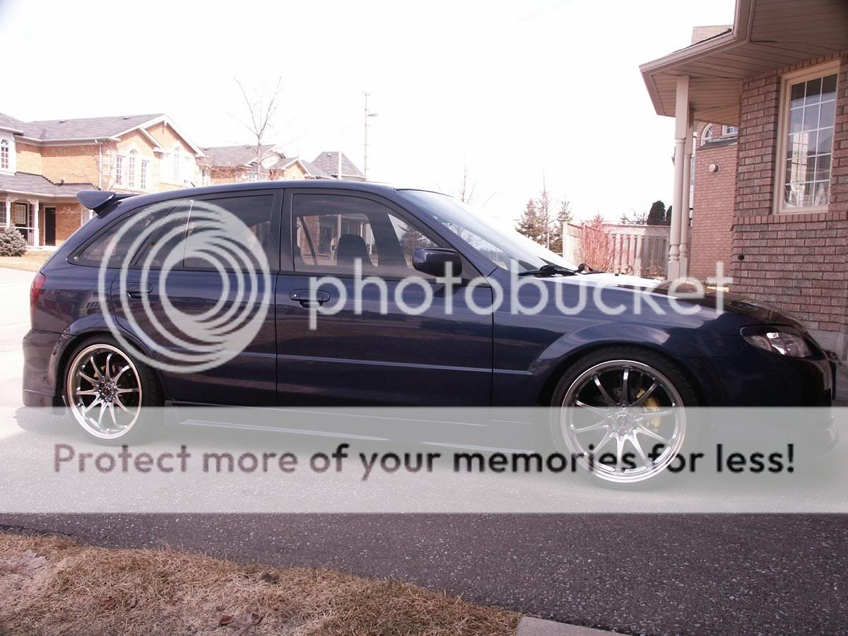

Rev Model II - Hyperblack
18 x 7.5
+45 offset
Only time I've rubbed is with a full car (5 adults). If I rolled the fenders it would solve that problem, but I don't really ever drive with that many people. I was just testing it out.
I'm VERY happy with these rims. Love the new look.
sorry for the huge pics. I'll try to re-size them tonight if I remember. I just linked to whatever I had in photobucket.
