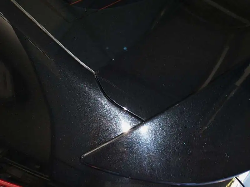

Look at Dupli-color BMZ1159 16w
The picture is an aftermarket universal rear spoiler that I sanded primed with rattle can and applied the Dupli-color BMZ1159 16w . This was 2 years ago . This picture I just took.
