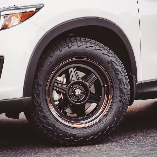

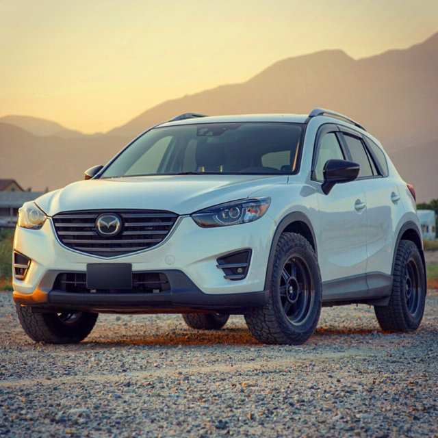

I'm really happy with how the wheel and tire set up turned out. Did a little "off-roading" and it was a breeze.![]()

	Damn, those tires sure fill the wheel well! Thought about raising the ride height? Where did you get that set up? Brand wheels?

I'm looking for a place for a custom lift. Nothing crazy. 1"-2"
Wheels were custom made by Motegi Racing. They are 17x8 30+ 2-piece MR224 forged lip/ cast center. Tires are 245/65/17 WILDPEAK A/T3W. They're 29.5" tall

Are these really +30 offset? IF so that would move the outer edge of the wheel 3.15" out away from the hug, plus another 0.5" for the wider wheel.
It doesn't look like those are 3.5"+ farther out. They look more like -30 offset, but I could be wrong....?
	this is with a +35 offset, i believe you are getting +/- offset mixed up....
im running a 17x8 +35 offset
