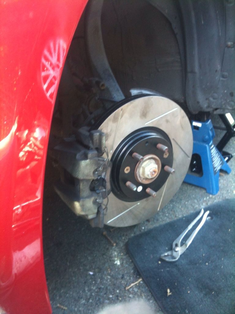

so I replaced my front rotors and pads with stoptech slotted rotors and Hawk HPS pads. so far, very good. there is no noise, almost no dust and the stopping bite is violent. installation was pretty simple although the bolts were hard to get off (one bolt took me nearly 2hrs, but i got that mu******** out).
here is a quick pick that i snapped. i was gonna also paint the calipers but i couldn't find G2 paint locally so i put it off until i get wheels, its not like u can see them with stock wheels.
Looks good. I also have the RedStuff brake pads, but stock rotors. That combination dusts as much as the OEMs. Glad yours is working out for you!
HPS definitely has less dust than stock (i have put them up to some heavy tests :P ) with that said, they still produce dust just no where as much
