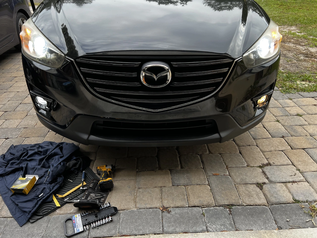

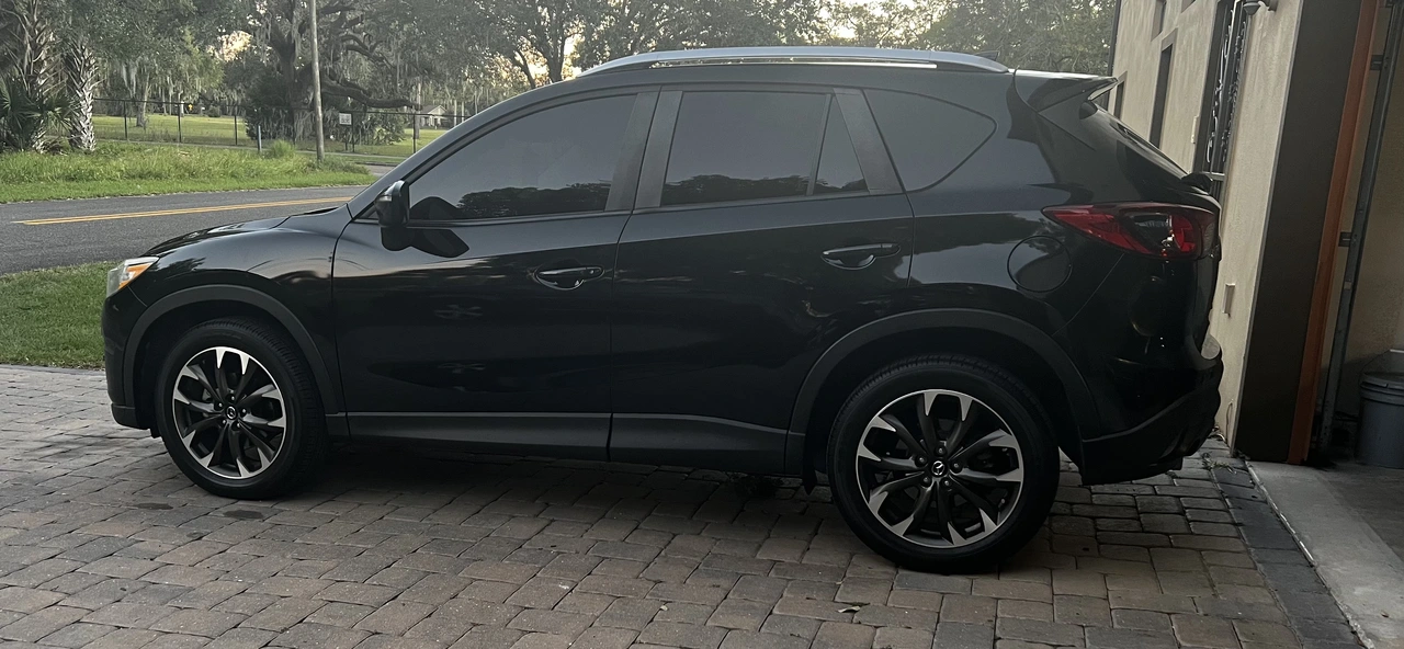

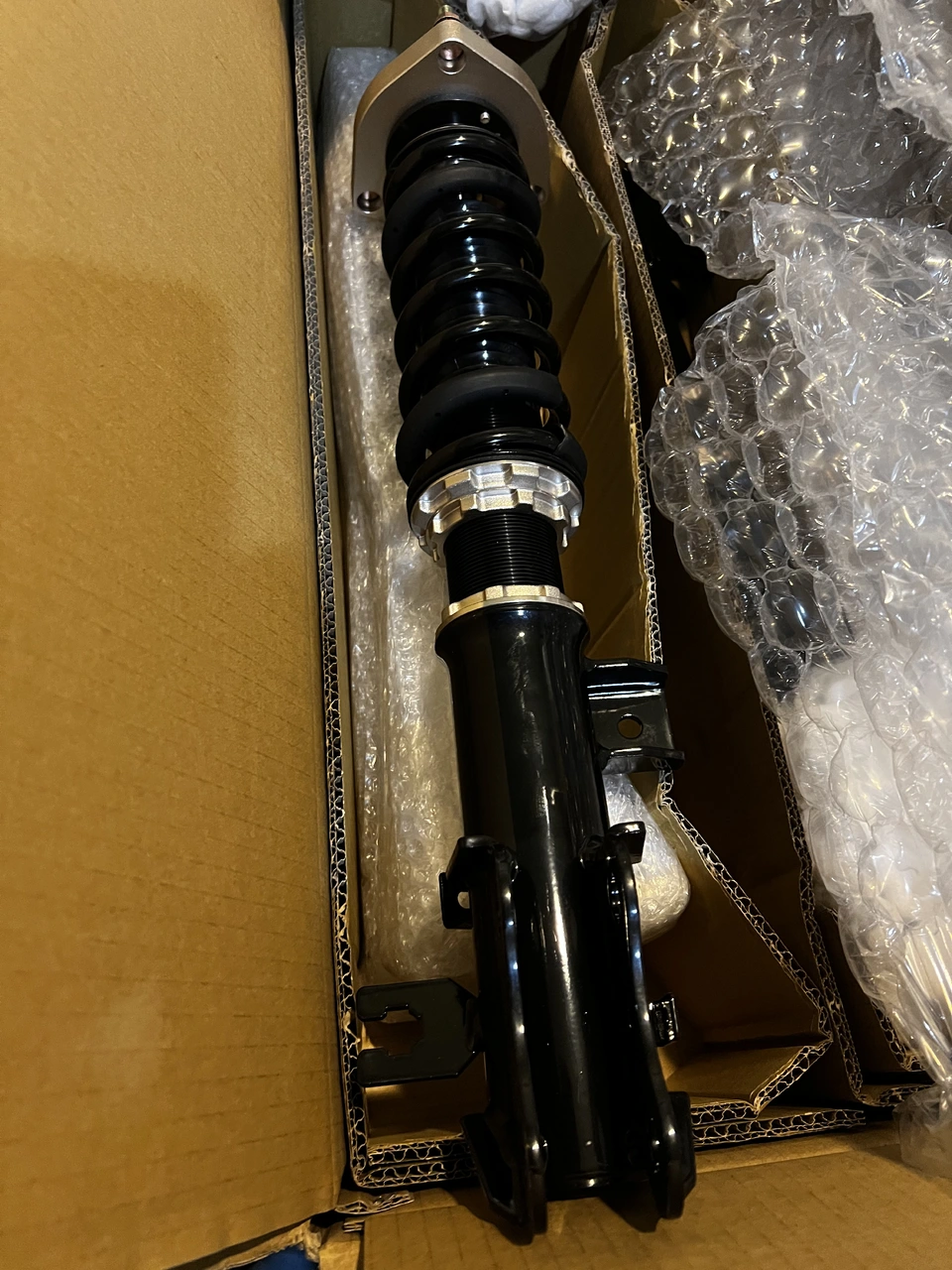

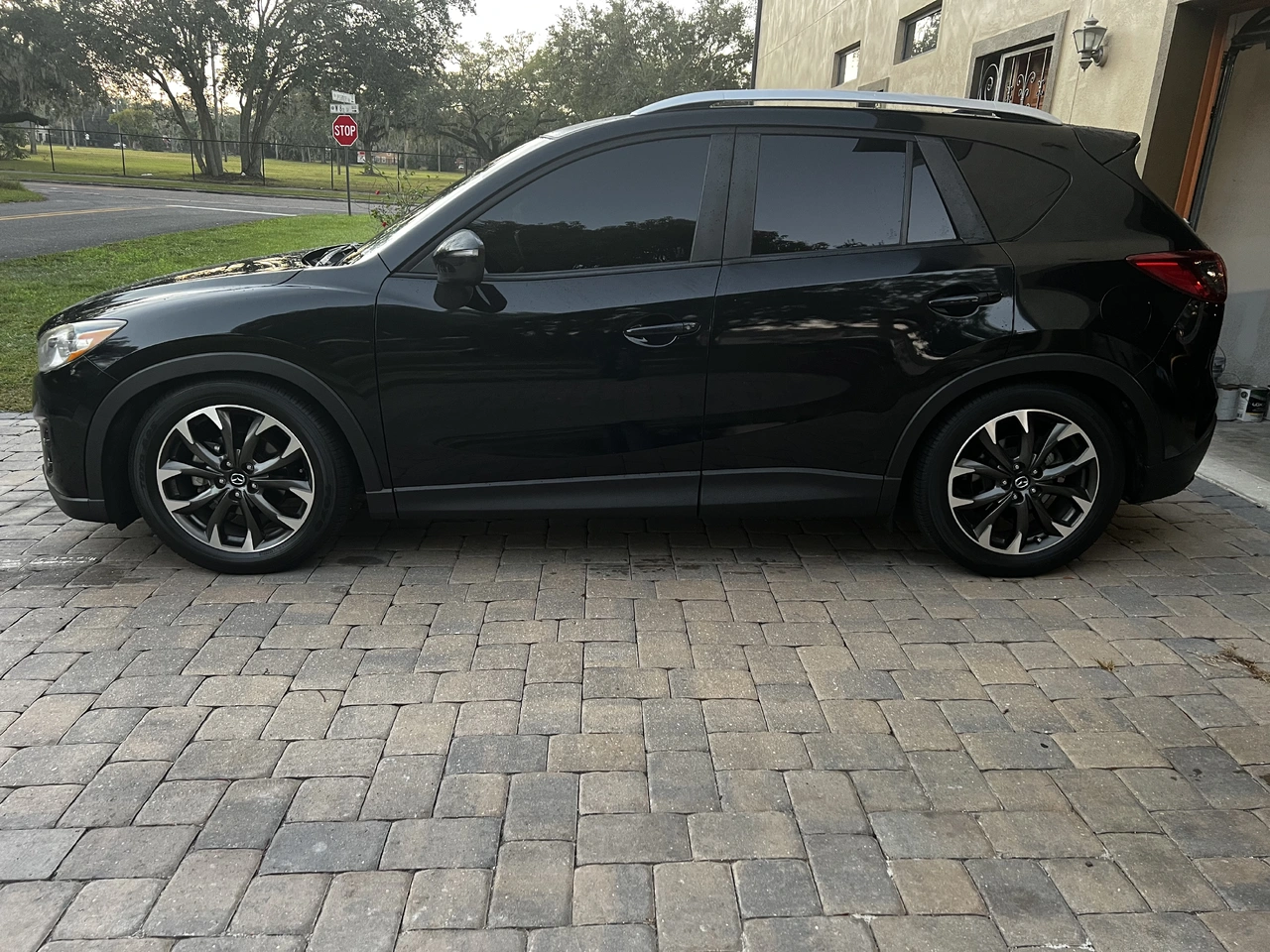

BC Racing coil overs 2 1/2 inch drop front and back! Replaced all lights with Auxito LEDs photos to follow.
Looks great! I have BCS Racing on our 24 CX5. I only dropped it 1.5" front and 2" rear. "We" have issues parking and not putting the front on the curb. This was the happy spot.

Yes I lowered 1.5" front, 2" rear. There is room for more drop in the rear. I'll crawl under the car tomorrow and see if I can get a picture of the spring.

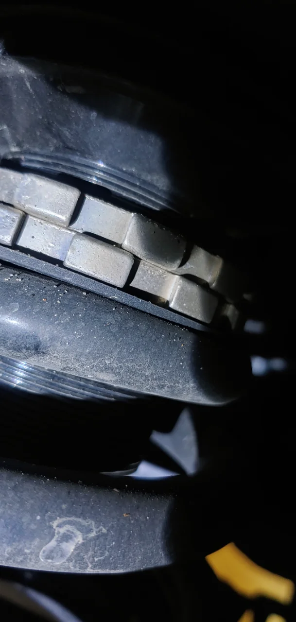

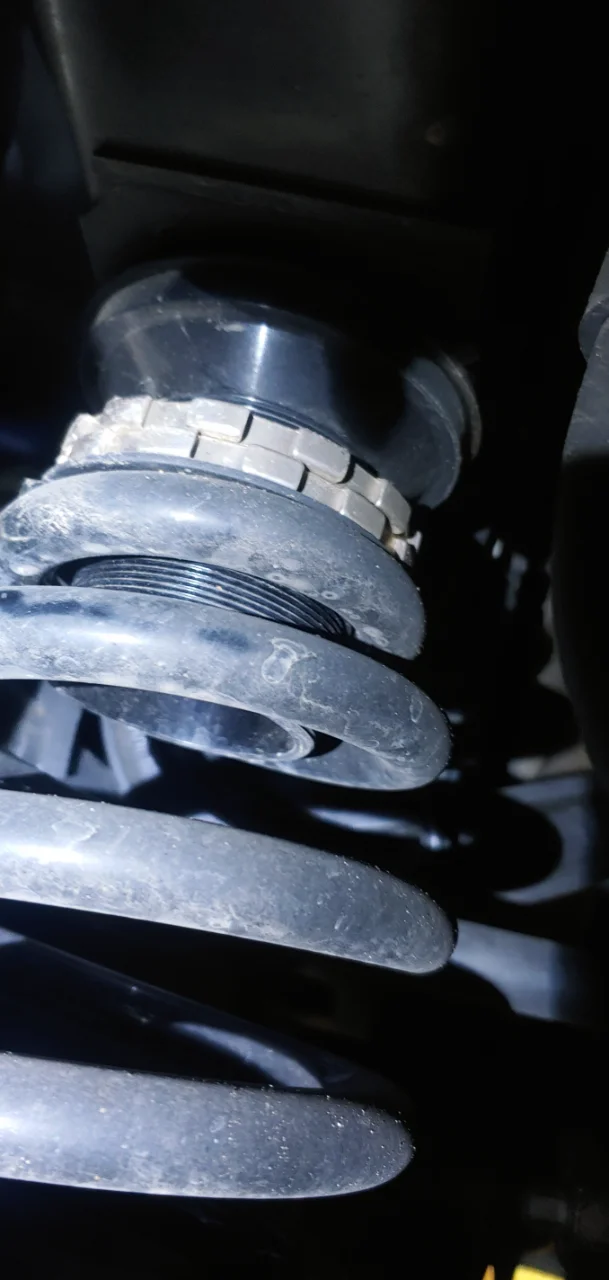

Here are the rear springs wit 2" drop. It looks like they will go down another 1/2".
I'd be unhappy to with how your ccurrant setup is "working". 😑

Here are rhe rear springs wit 2" drop. It looks lime they will go down another 1/2".

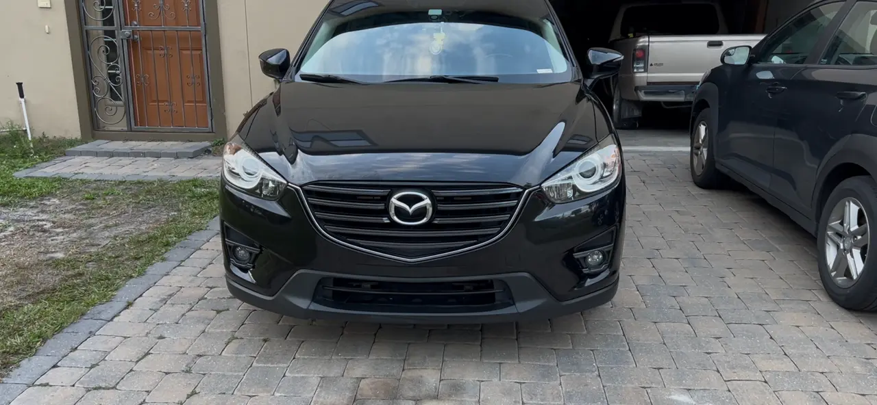

Odd that you're adjusted that far down, yet not much visually different than CS springs (maybe even higher). Other CX5's I've seen are absolutely SLAMMED on the bc setup. Seems like something isn't right here.
Remember there is the low and ultra low setup from BC. Iirc one is up to 2" and the other is for over 2". Might be the difference with his.
