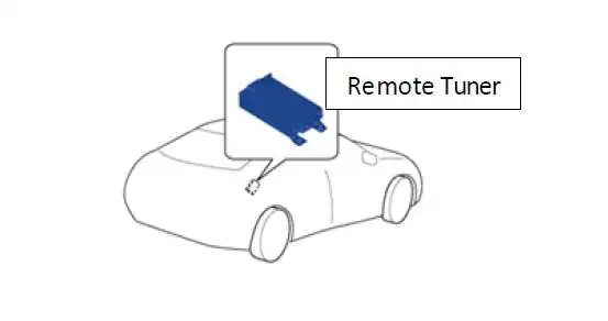

Mazda has recognized that the 2023 CX-9 and CX-5 (Canada) has an issue with it's Remote Tuner module and software associated with it by the manufacturer of the unit.
These Remote Tuner modules were built with outdated software and therefore the power shutdown processing of the module may not be completed.
In this condition if the vehicle is left unused for a certain amount of time the battery may discharge and run flat.
The Remote Tuner module controls the audio signal from the entertainment system.

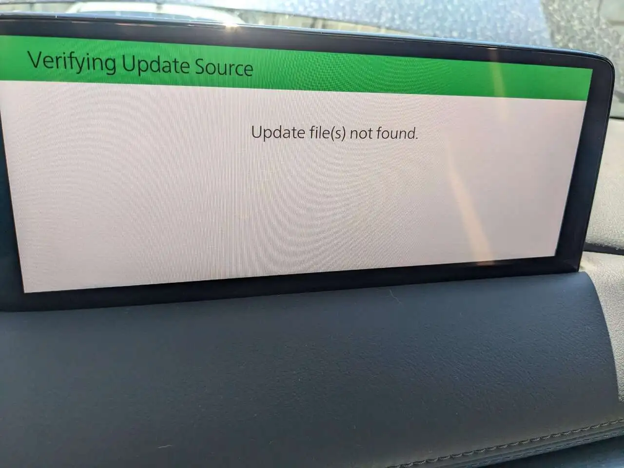

Is there any specific procedure for creating USB drive with update files?
I've tried to download ".kwi" files form the links provided in the doc, and simply pasted those into the formatted USB flash drive (FAT32), but my Mazda can't see update files there when trying to update software in Diag mode. Did anybody has same issues or know how to fix it?
