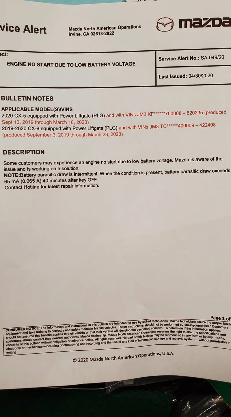

I had this same mysterious parasitic draw problem causing a dead battery with my 2020 CX 5 Signature back in early April. I must have been among the first owners to report the issue. It took several weeks to sort things out. My dealer consulted with Mazda tech support and the issue was resolved by replacing the rear lift gate control module. The battery problem has not recurred since. The rear lift gate control unit part number is KBG6626H0C. The part number for the original and the new replacement is the same, however the replacement has a white paint dot in the upper right corner to distinguish it. The problem affects certain CX 9s as well as the CX 5. A TSB initially issued on 4/30/20 was recently updated with the VINs of affected CX 9 and CX 5 vehicles.
Thanks for that valuable info. So, theoretically, Mazda has identified the vehicles by VIN that have that defective part and only need to check your vehicle's VIN against that list?
Apparently the manufacturer of this module either produced defective parts or parts with a bad design. And, apparently, Mazda has identified the production run of bad modules. Mazda Motor Corp. really needs to send notification to every owner of cars with this group of modules, but maybe they first need to get an adequate supply of good modules in the warehouses and dealerships.
Yes, you just need to check to see if your VIN is among those that are affected. If your vehicle has the parasitic draw / dead battery issue and you’re VIN is not on the TSB let your dealer know. They only discovered this in April and I had to push my dealer to elevate it to get Mazda to acknowledge the problem. They may still be learning the extent of it.
