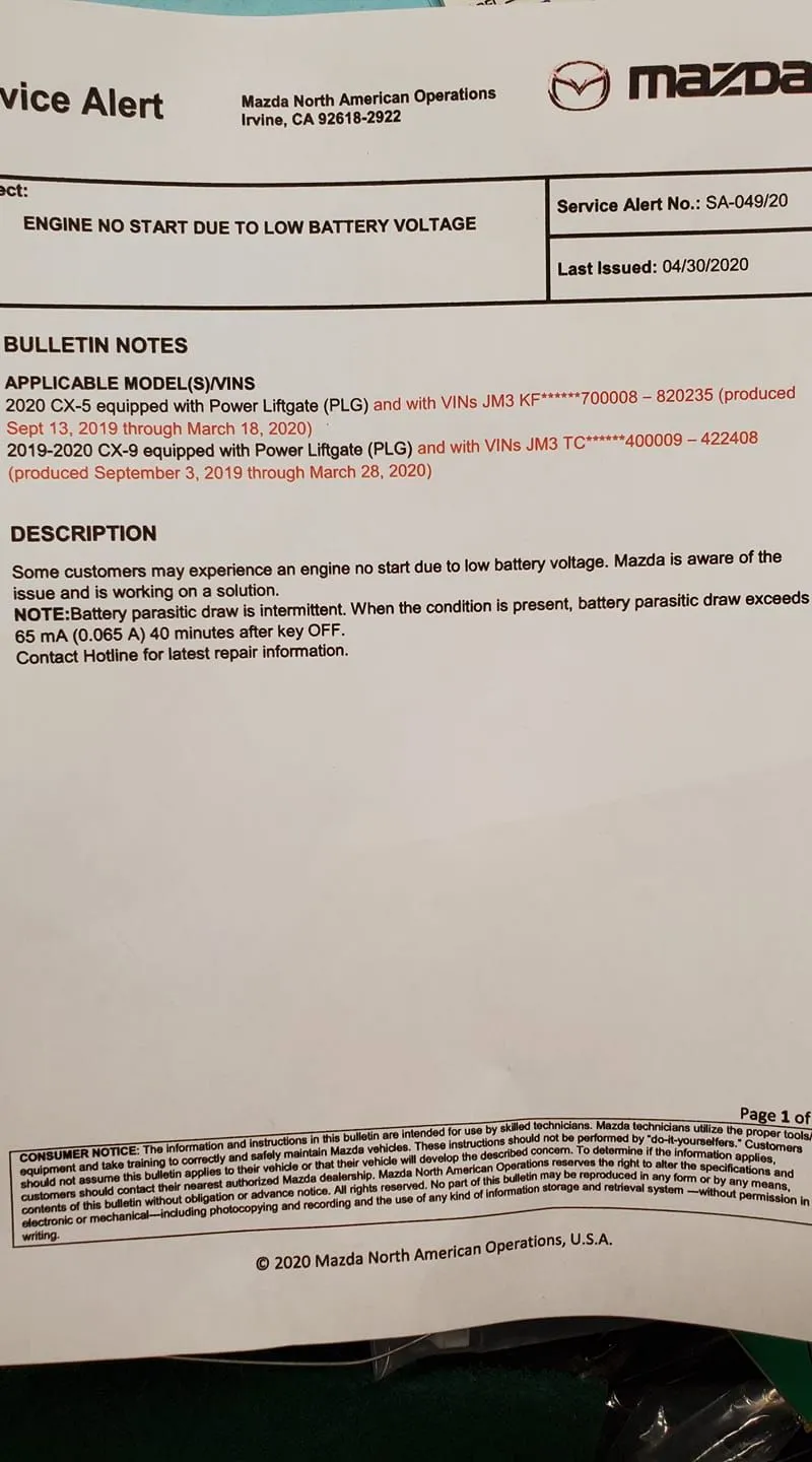

Yes, you just need to check to see if your VIN is among those that are affected. If your vehicle has the parasitic draw / dead battery issue and you’re VIN is not on the TSB let your dealer know. They only discovered this in April and I had to push my dealer to elevate it to get Mazda to acknowledge the problem. They may still be learning the extent of it.
Thank you so much for posting the actual TSB. I searched the Internet just now but could not find any TSB info related to 2019 or 2020 CX-9s. This info is gold. My car definitely falls within this range.

Where did you find the vehicle Vins that are affected? I think I am overlooking it.
See red text in the TSB (attached)

Picked up a 2020 Sig 8-8-2020. Signed up, 8-11-2020, for My Mazda and the site popped up the service alert, attached.
Dealer salesman dropped off a loaner and took the CX 9 last night. The plan is he'll bring mine back ,fixed, tonight.
The service is great from the dealer.
I'll post an update when the cars back to me.

Trygg posted a service bulletin that addresses this issue. My vehicle's VIN falls within the range of affected vehicles, but I do not have any reference to a recall through the My Mazda app. Hmmm...

Something seems strange, can you check your VIN on a Mazda based website and see no recall/TSB info? I wasn't looking for anything with regard to my vehicle it just "showed up" when I logged in. You've said your vin falls in the shown range , so something smells off. I wish I could offer a suggestion, other than to push on the dealer(s) you are able to.
Mazda has finally issued a formal recall on the power lift gate/power drain issue. The two dealers I previously took my car to were rather dismissive.
"On certain subject vehicles, the Power LiftGate (PLG) Control Unit may not switch to the power saving mode even after pressing the push button start and setting the ignition to the off position..." Mazda dealer will replace the PLG at no cost.
For questions, call Mazda at 800-222-5500 option 6.
