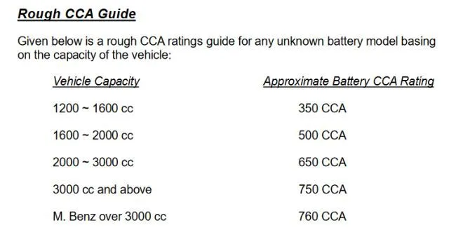

edit to add: Here's a pdf for specs on the Japanese battery standards. This is a resource from AETOOL's website. They make battery analyzers.
If Mazda Customer Service is correct that the Sig battery is JIS 55D23L, and the pdf is accurate, then the Sig's CCA specs are:
Wet: 355
MF: 480
CMF/MMF: 500
There is this note at the end of the CCA table for each specific JIS#:
