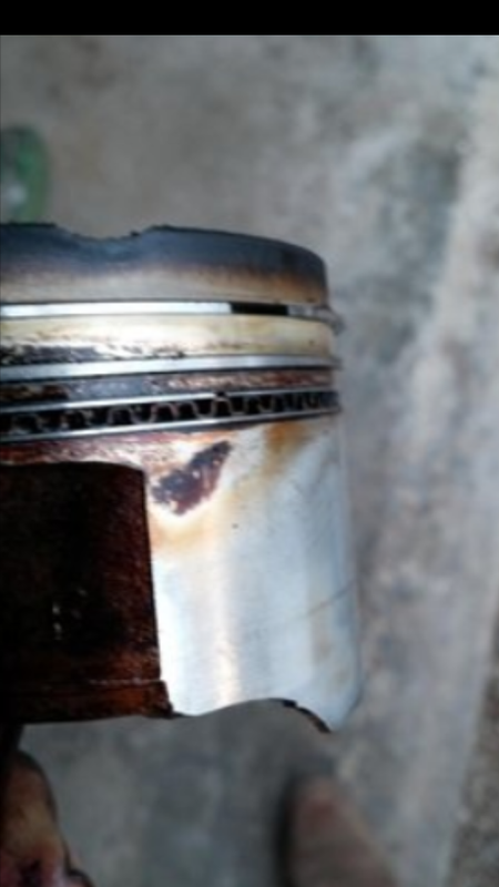

It might be your oil rings, these fsde engines have really weak rings that don't get a lot of oil and tend to seize up. I've had luck with using seafoam in the crankcase and gas tank to help clean up the Smokey start up. I do half in the crankcase and half in the gas tank, with a full tank. Then drive it for 200 miles and change the oil and filter.
