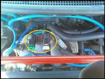

Check the wiring to these solenoids the ones circled here are the VICS and VTCS I believe the VTCS is on the left and VICS is on the right.
Sent from my Moto G Play using Tapatalk
The FPR solenoid is also in this picture to the right side partially underneath the two black hoses with a blue vacuum line attached to it.

The vacuum switching valve you found is exactly what you need. The FPR solenoid, VICS solenoid, and VTCS solenoid are all the same part, just make sure that you connect the vacuum lines up how they came off.
If you look at the picture the oval piece under where the electrical plug connects is a miniature air filter, it should be removable and might go into a different nipple of the solenoid if the vacuum lines are configured differently.
WOW! ok i feel dumb now that i look at it i see what you mean. that really helps! i just have to save the money to get them cause they are like pretty expensive if you buy all three. im going to see if i can test them. maybe i don't have to buy all three
Check resistance across the two terminals with a ohmmeter if you have one, if they are too expensive replace just the FPR solenoid, as it is likely causing your concerns. VTCS is for warm-up emissions, and VICS is for high RPM air flow (switches the manifold to larger runners at 4600RPM. Neither of which are needed for the engine to run. Control of the fuel pressure however is likely causing your concerns.
