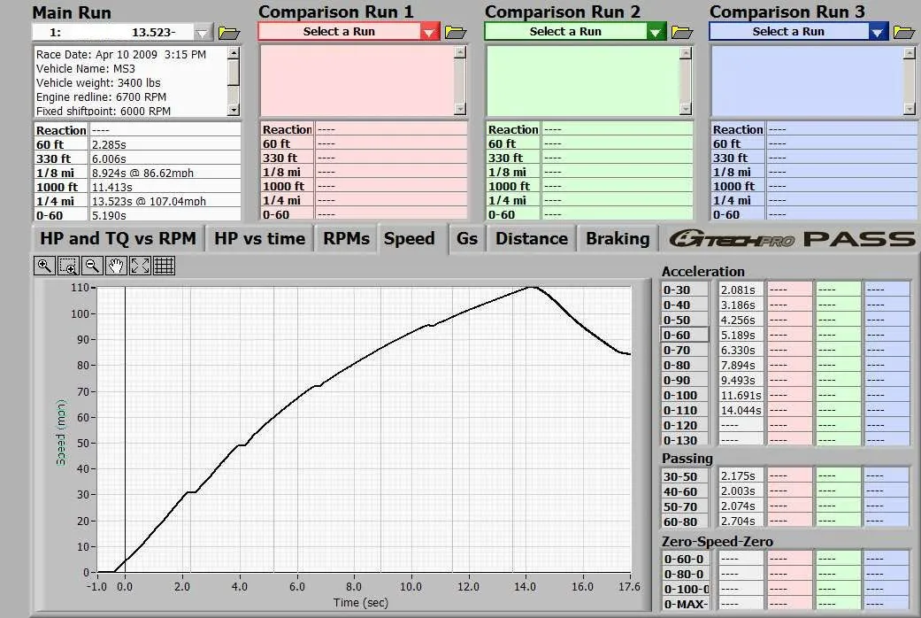

There are some performance parameters that an accelerometer can show that you can't get from a Dash Hawk or from the drag strip slip. Performance "up top" say 60-100 or 110 mph is a good indicator of engine performance. By 60 mph you are into third gear and away from the "engine nanny" torque limits of the lower two gears.
Does this look like a leaking stock BPV? Unless you are hitting 100 mph in less than 11.6 seconds, we don't have much to talk about with BPV's.
