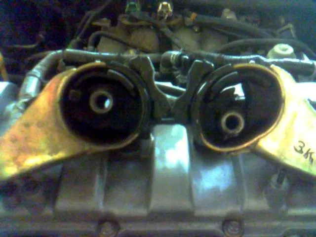

Attached is my stock motor mount on the left and Aaron's (EmbriMSP) stock mount on the right. He had some wheel hop and still took it down the drag strip and this is what happened.
He now has AWR in all 4 mounts.

The stock front and rear mounts both were riped (but not as bad as rednecks_r_us has in his picture), and I also can see that the passangers side mount is riped from the inside.
