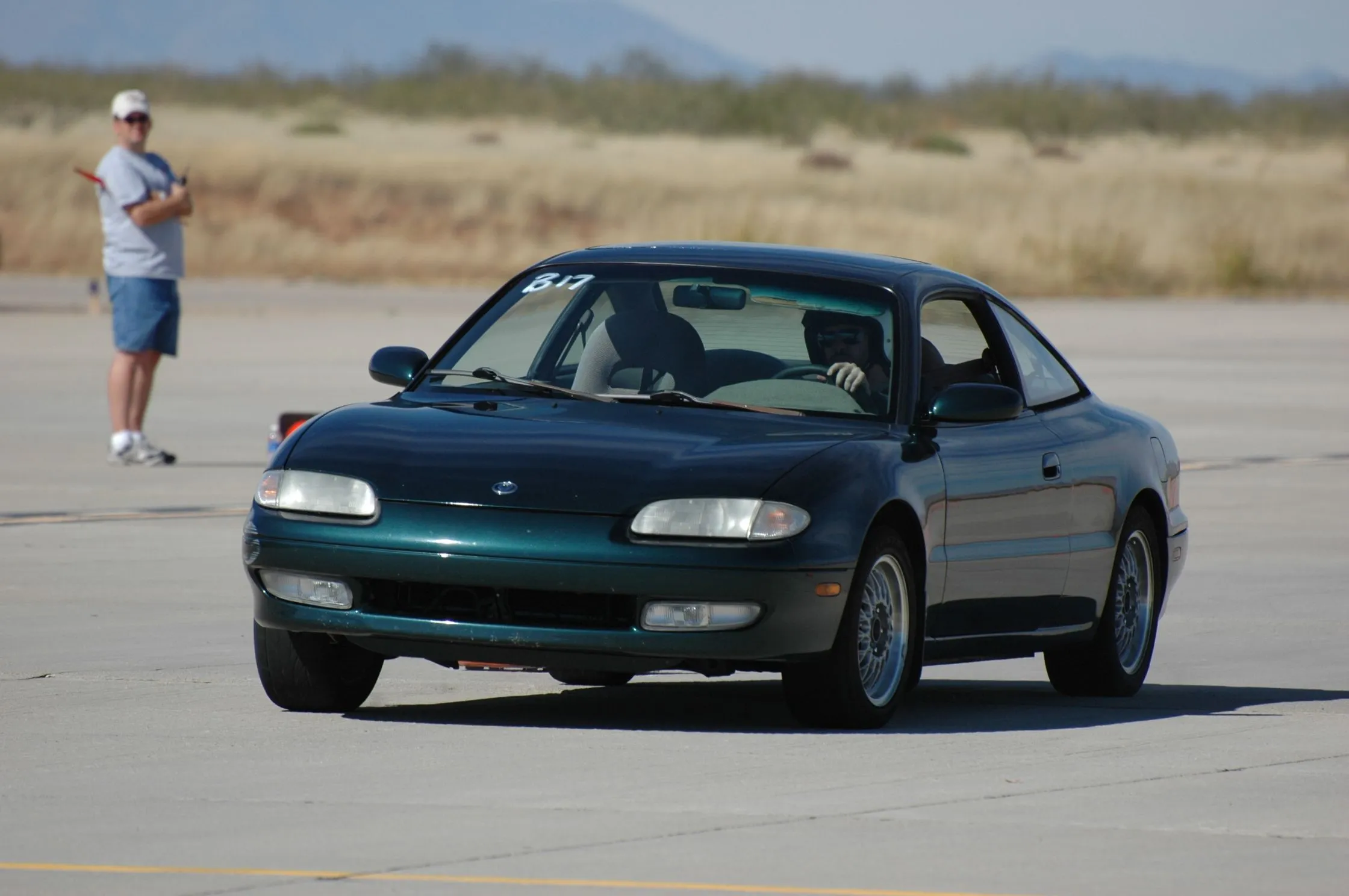

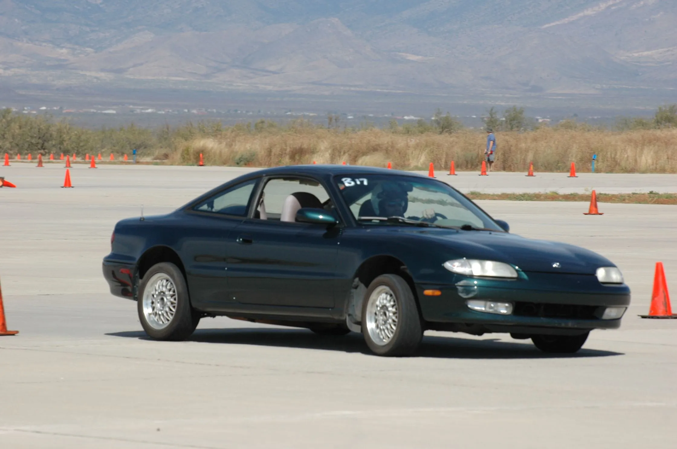

Eric, if it's feeling better, AND you're going faster that's pretty positive affirmation right there :p
Sorry for the lack of pics, here ya go. A little oopsie from last years season finale. :D
Yes, those are my sig pics. :)
