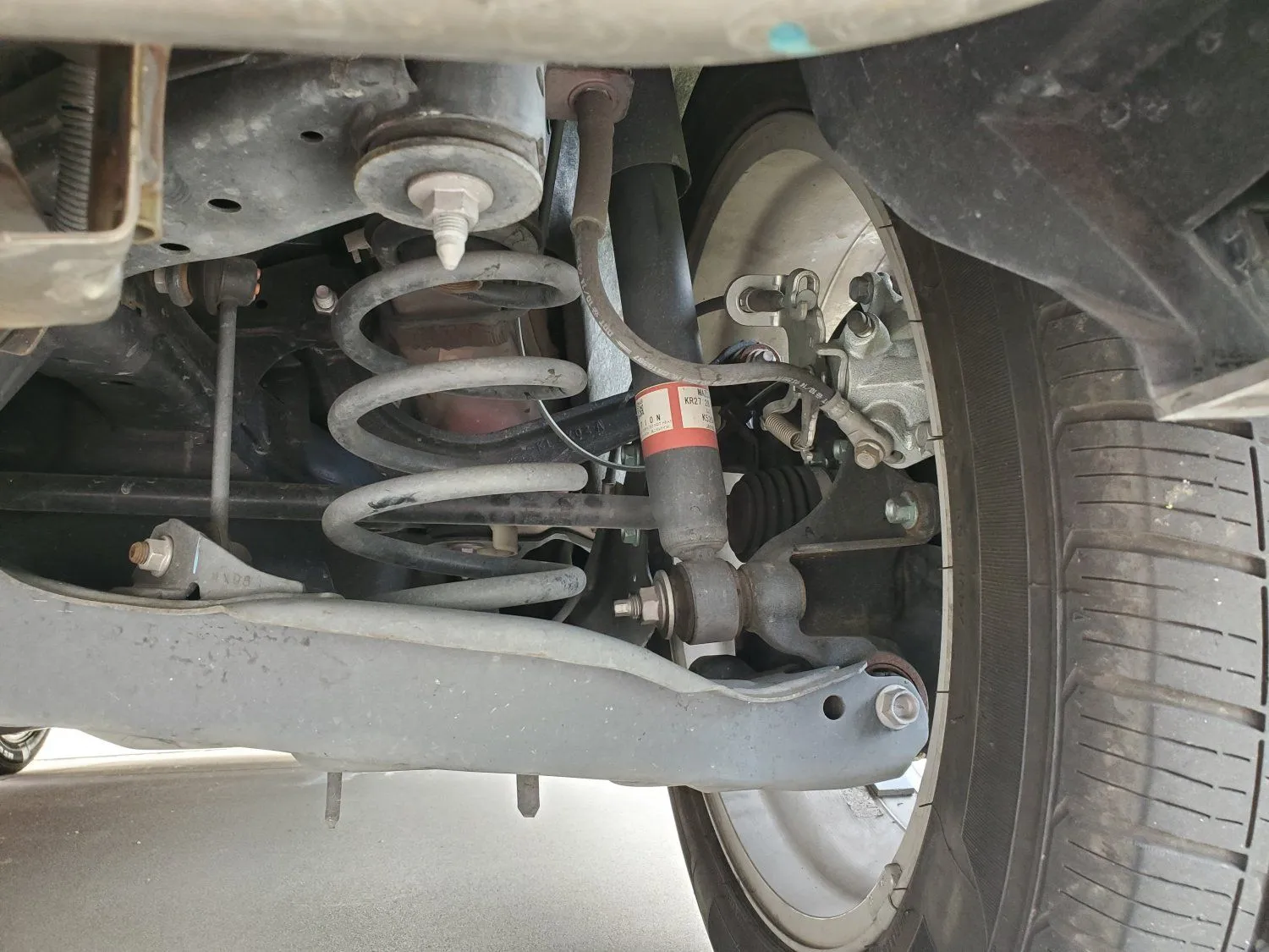

Hi guys! As of yesterday I am the proud owner of a 2015 CX-5. The dealer says it's an AWD but there is no badging or anything inside the car to indicate this. Is this normal?
I've included a pic of the underside of the back. I think it looks like AWD from what I have seen online but I have never had an AWD before and really don't know much about cars.
Does this look right for a 2015 CX-5 with AWD?

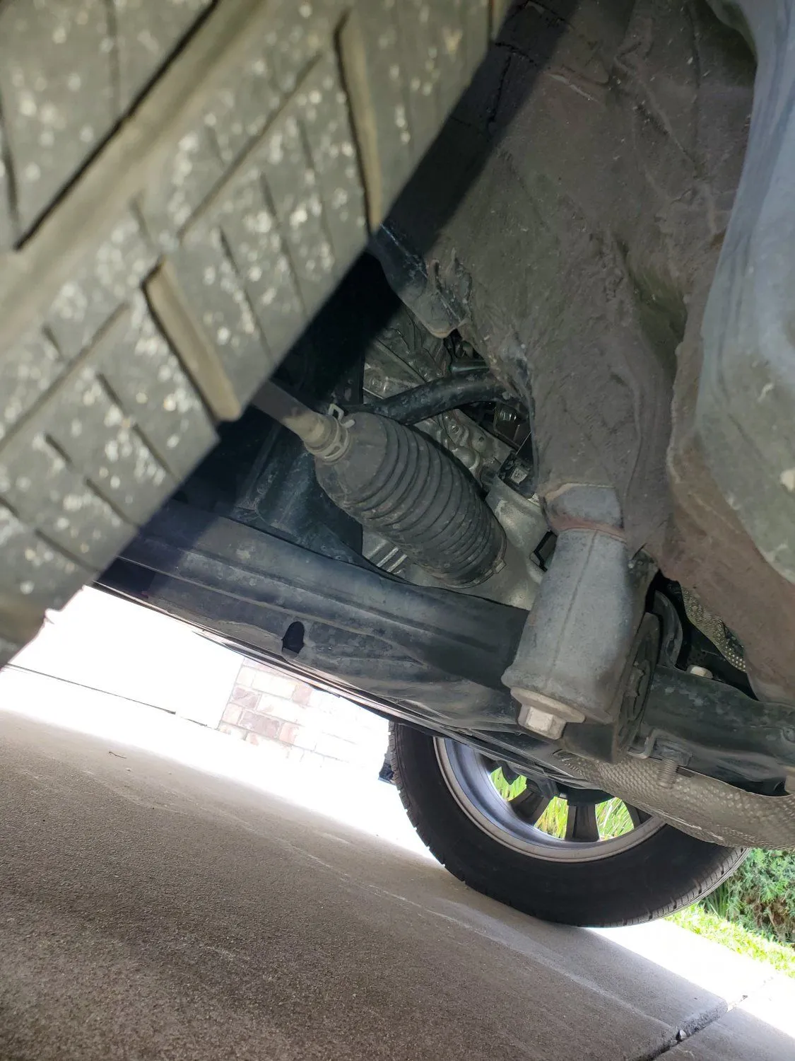

Thanks for the tip. I am not sure what a transfer case is. Mine seems to have a big plastic thing covering whatever is in there. (Pic included of underside front.)
My AWD definitely has a badge. Other way to check I think would be to see if your CX-5 has a front transfer case. If it does, it's AWD, if not, it's FWD.

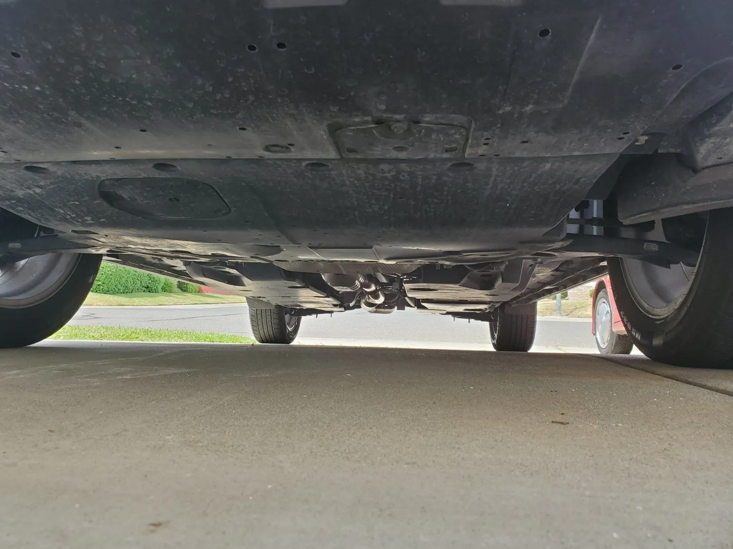

Here's a pic of whatever is going on under the front of my car in case it helps (this is looking at front wheels from behind).

Like stickerbush said, we can see a drive shaft goes into the right rear wheel in the first picture hence your CX-5 is an AWD. You should have an AWD badge on the hatch so I suspect either your CX-5 had involved an rear-end accident, or the badge somehow got lost although it’s highly unlikely.

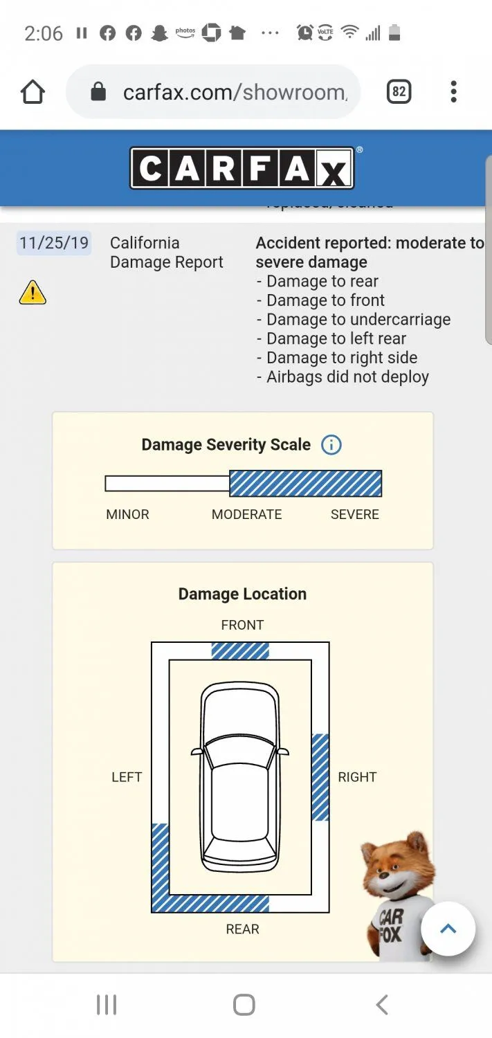

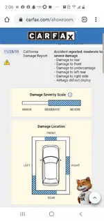

Thanks so much for this post. I just ran a Carfax (yeah I know I should have done this before I got the car....but Carmax, where I purchased the car, ran an off-brand report for me and I thought it was the same), and the vehicle seems to have been in a fairly major accident. Luckily Carmax has a 7 day return policy. Sigh.
Like I guessed. One of the reasons I usually don’t buy used cars. Too many unknowns.
Take it back immediately, false advertising, shouldn't even be a question if you get your money back.
Carmax deals imo stink, not knowing the purchase price .....I'd take a guess they listed it at the same ballpark as a non-accident car. Not good.
Thanks everyone. The report Carmax ran was an Experian report. It did show an accident with no airbag deployment but no other details. I figured it was just a minor collision but apparently Experian reports just don't show all the details.
