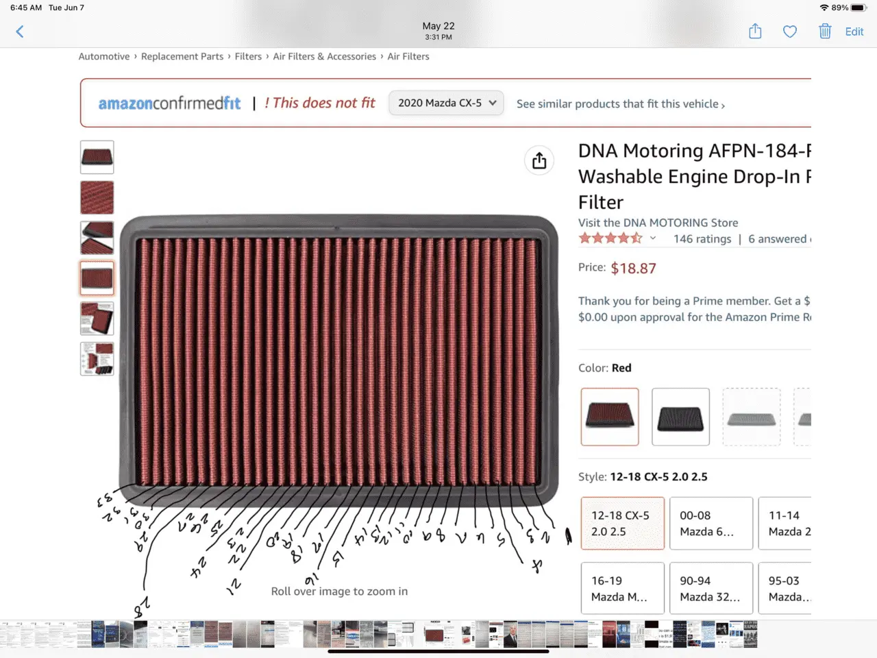

I would try this one first. They say you clean your k&n filter and over oil it it can eventually mess up something in your car. I have been impressed with this you can clean it and it’s a lot cheaper.

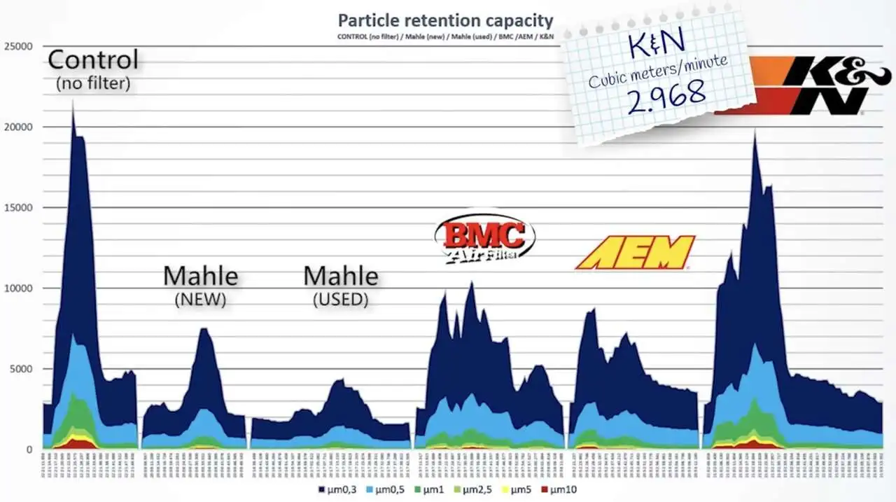

While I’ve used K&N filters for many years - before I lived in a desert environment, I no longer do. The only two ways to (practically) improve airflow through a filter element are to increase the surface area, or increase the size of the openings. Drop in filters usually decrease the filter area, so if they actually reduce the restriction then they must have larger openings. Actual testing (both oil analyses and particle pass-through) clearly indicate much less efficient filtering. If you want to keep your engine healthy for a long time in dusty environments, eschew the K&N drop in filters. They are almost as terrible at filtering as no filter.
That chart threw me, I have to admit I had no idea what it was trying to convey. Here is the YouTube link: Performance Air Filters - K&N vs AEM vs BMC - DYNO TEST
I was like, how can no filter retain any particles? There’s no filter! The K&N filter retained a ton of particulate!
Ah, ok. A standard amount of particulate was dropped on a test rig. No filter, that’s the standard load of particulate dropped on the test rig and counted by the device. Each test after that is how much particulate made it through the filter. A perfect filter would catch all particles and have no data plotted. The chart should be titled particles that weren’t retained, or particles that were NOT caught by the filter.
The lower the spikes, the more material was retained by the filter. OEM filter is by far the best at collecting particulates. K&N is almost the same as nothing at all.
