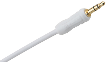

So when i first got my car (Aug2007) i noticed that when you have an MP3 player connected and when you drive, you get a buzzzing noise from your speakers. At first i bought the ground loop isolator that everyone loved from Crutchfield and then purchased my 3.5mm cable from monoprice.com. Now, this combo worked flawlessly, that is until the damn cables kept on screwing up. Ive ordered about 3 or 4 of them and they all have gone bad in a short time. So i decided that i wanted to get me a fancy one with a stronger base connector, cause the cheapy ones kept on messing up due to the cable being bent so long and under the sun. So i decided to go big and get me the Monster Brand cable (yea, they rip people off i know). So when i opened it i noticed it said it had this "double-helix" design to cut out all grounding issues in cars...yada yada. I said screw it, im gonna connect it without the ground loop isolator. I started driving off and VOILA! It works! No ground loop isolator needed and it was only 19$ for the cable. Thats a savings of 25$ right there. Here is the one im talking about. I found it at Target btw.

I see it says it works on iPhones, but has anyone actually tried it...the iPhone/iTouch have a very deep insert and skinny also.
Yea its made for the iPhone. But also works on any other 1/8th" connector (3.5mm). I was simply in awe when i used it, and to think i was gonna go with another connector!
