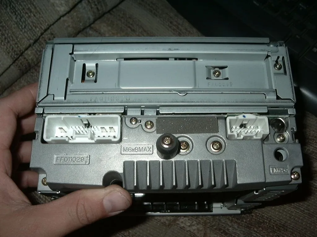

There is a 16 pin on the back of my 2003 Protege5 HU. Here is the photo I took of the back of the HU when I had it out of the car. This 16 pin was unused on mine. It is not for the tape/md it is for something else maybe a CD changer.
Here is a link to the photo (large 650 K):
http://www.bendersolutions.com/protege5/P1010010.JPG

alright now you know theres a plug, so are you gonna test it out for us? (yes)
It looks like it might possibly be it. Hopefully I can check this out further this weekend, and let you guys know.

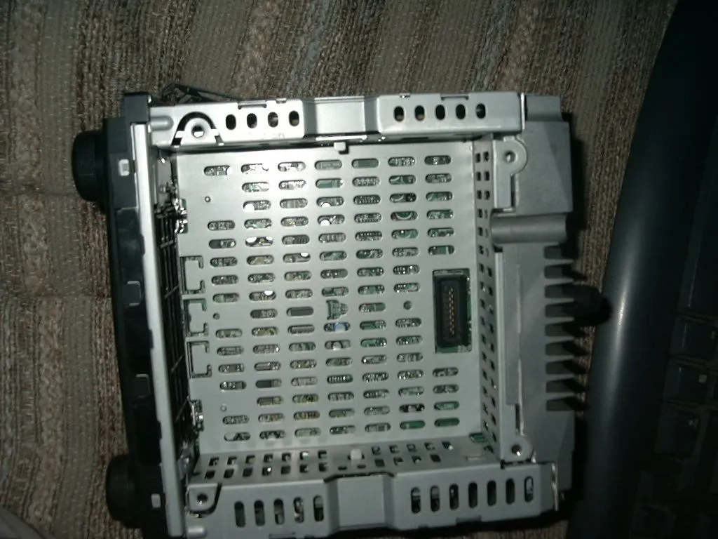

Mine is still sitting on my floor...
As for ppl being "cheap" The stock headunit is a pretty nice piece, plus there's the inherant theft deterrance that's hard to fault. That aside, I'm wanting to turn mine into a garage stereo...

Sounds like the same thing that PIE is offering, except in an all-in-one package. I'm going to try pulling my stock HU in a bit once I get my sons to bed; hopefully I'll be able to pull this together tonight yet.
OK - I can say that this adaptor from PIE works as stated. That extra plug on the back is truly a data port for an additional input, whether it be a disk changer or this adaptor.
