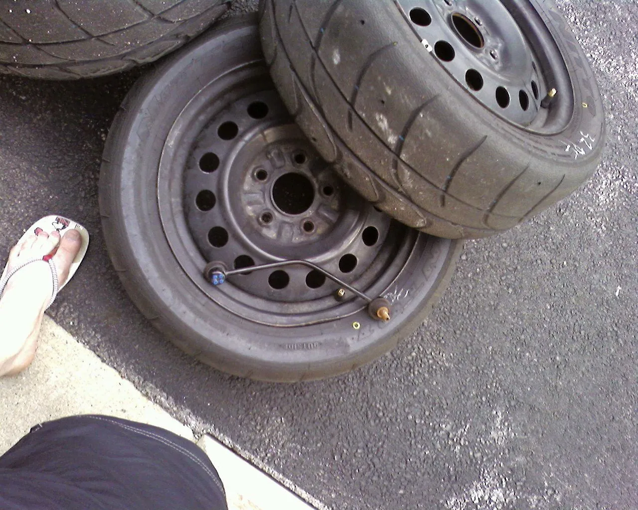

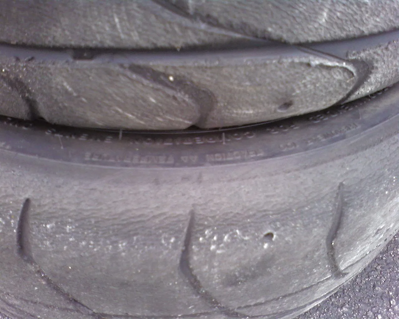

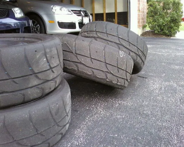

34! 34! yeah right. maby for you but I near ripped the sides of my new tires off. I started out that way then pushed all the way till 45 front and 34 rear. great felling tires plenty of braking and half the tourqe steer. wasent getting my best times but as I was getting close to finding my PSI I pushed into the front of a rumble strip and bent my front end link. after that I just had fun with a STI as we dominated the track (slow ass porsches).

What are your alignment settings? I had about -2 camber in the front at Mid-Ohio and am now at -3. I was slipping and sliding up around 45 psi. 34 just felt planted and it showed in the lap times. Also, what is your rim width and tire size? I am running 225/45/17 on a 7" wide rim. Do you happen to have any pictures of your car on track? It would be nice to see how much it is leaning and losing camber. My car does not roll much with the stiff springs and large rear swaybar.

225/45/15 on a 15x7 should be fine. Looking at the pictures of the sidewall, I would think it has to be the car rolling too much. I am at 500 lb/in front and 450 lb/in rear with the AWR rear swaybar basically on full stiff. I'm not sure where the normal Ground Controls are but probably 250 to 300 lb/in. I think another degree of camber in the front would be a huge help to you.

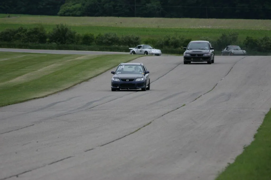

sweet sounds good! all the pics i have are just straight. but I will see about getting some more camber in the front. was thinking of obtaining some camber plates but, I think I need some better wheels first I keep boiling the brake fluid. peice by peice I get there.
