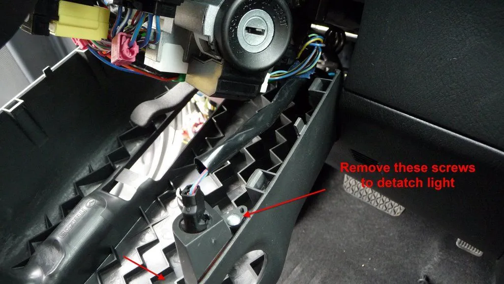

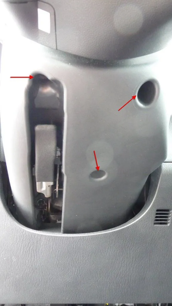

For those that have a CX-9 without the auto headlight option, here are some installation notes for the Directed Electronics 545T Nite-Lite System, to add the auto-headlamp function. I've also attached some pictures.

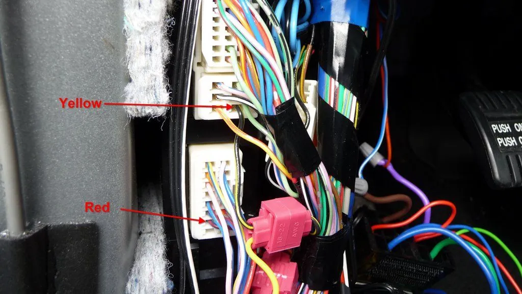

There are three plug blocks right next to the driver's door jam.
  1. yellow wire -> tap onto black/yellow wire on the 3x2 block
  2. red wire -> tap onto blue/red wire on the 8x2 block

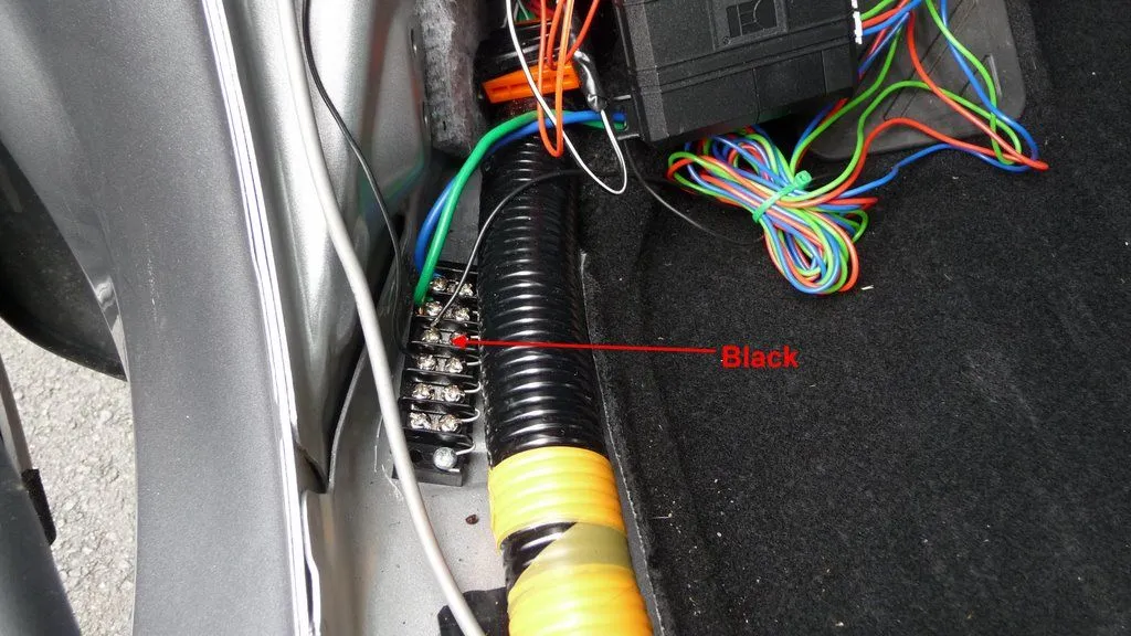

  3. black wire -> chassis ground (I added a screw terminal block to the door jam area since I needed several ground connections for other projects)

  1. blue wire -> chassis ground
  2. green wire -> chassis ground

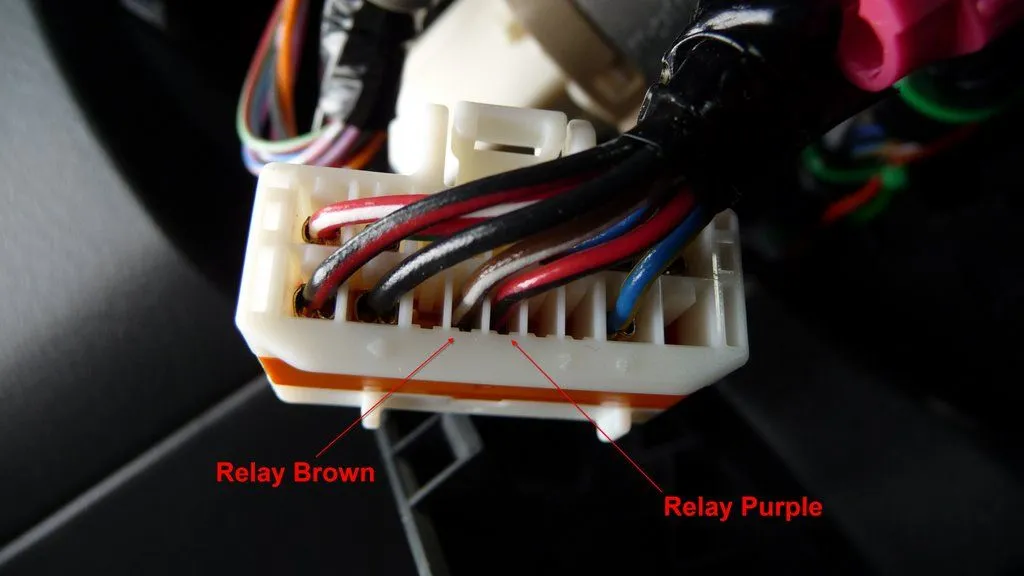

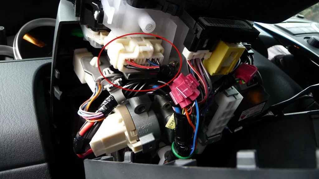

  3. purple wire -> tap onto red/black wire on turn signal connector block (on steering column)
  4. brown wire -> tap onto brown/white wire on turn signal connector block

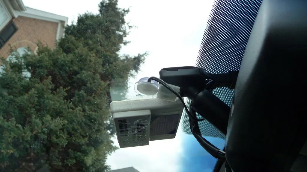

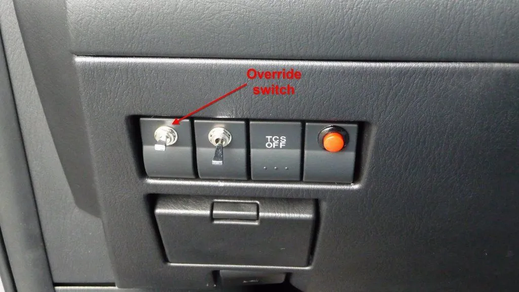

The pictures attached show the various connection points, and I also show where I mounted the sensor up by the rear view mirror. I also added a switch to the dash panel to turn off the nite lite (hooked to the on/off switch of the unit).

This implementation allows you to leave the headlights on "off" and the nite lite system will automatically turn them on at night. But you can always manually turn on the headlights using the turn signal switch (like during raining days). The key to this wiring method is that it makes the dash lights work properly, so when the lights are auto turned on, the dash lights will dim properly. If you wire this up to control the headlamps directly, you have to manually adjust the dash lights.

That's why there's also an override switch to do what you just said :) Can't say if it will turn the lights off, but this comes with an adjustable timer which will turn itself off after the ignition is off :)

The switches on the dash panel are ugly. I completely agree. They are only switch covers, which can be easily replaced. I actually want to use (repurpose) factory switches, but I couldn't find the part numbers. If anyone knows the part numbers for those switches, I would much appreciate that information.
BTW, one switch turns on/off the nite lite system, one switch turn on the rear view mirror camera display at any time (without having to go into reverse) and the red switch is wired to the garage door opener, which I have velcroed behind the dash.

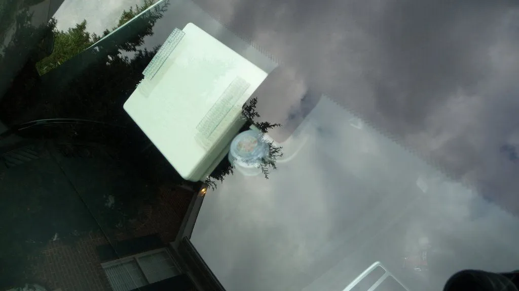

The big white thing on the windshield is an RFID box for the toll roads up here in VA. It's behind the rearview mirror and can't be seen by the occupants of the car, but it's in the recommend location to be picked up by the toll booth sensors.

You don't have to drill holes if you don't want to, I tuck them in the coin box which I am not using (2thumbs)
Would be nice if they can be replace with an OEM switches - can't find a part no. for that...any idea?

You are quite correct - and I appologise for my comment - I assumed that the white thing on the windscreen was part of the auto-light sensor system. Our E-Toll thingies are the size of a cigarette packet and we generally attach them to the sun visor.
