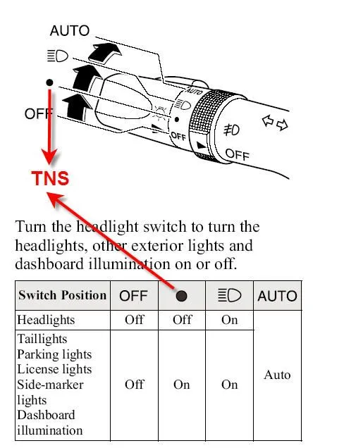

"TNS" position
Good question Tom!
Dont know what this TLA TNS stands for, but it must be a Mazda lingo for sure...
TNS is one of the four positions of the headlight switch between OFF and HEAD.
In other words when you turn the headlight switch the sequence is OFF TNS HEAD AUTO.
When the headlight switch in TNS position it energizes the TNS relay which directs voltage to exterior lamps (such as taillights, parking lights, license plate lights, side marker lights) and also to interior illumination and dashboard.

So, you don't have the manuals as PDFs... that means you typed in that entire auto headlight setting instruction set? Complete with a scanned diagram of the headlight stalk? And a chart with red arrows with drop shadows too. Impressive.
