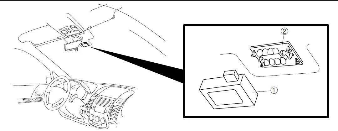

Did some more research. The auto daylight sensor is part of the rain auto wiper sensor.
Installed on the underside of the rear-view mirror (windshield center) and integrated with the rain sensor as a
single unit.
There are a few available on eBay, but I'm concerned that 1/2 of that sensor is glued to the windshield and would not be supplied from ebay seller. Plus, I would have to find the wire harness and some trim. Maybe too much to deal with. daylight sensor.webp
