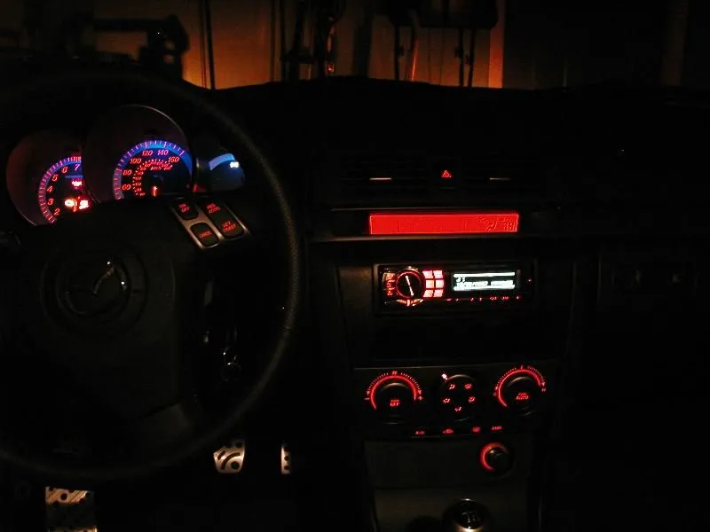

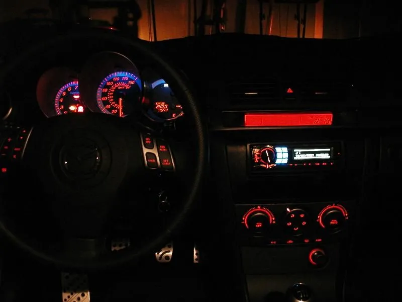

HU: Alpine CDA-9885 with dash kit

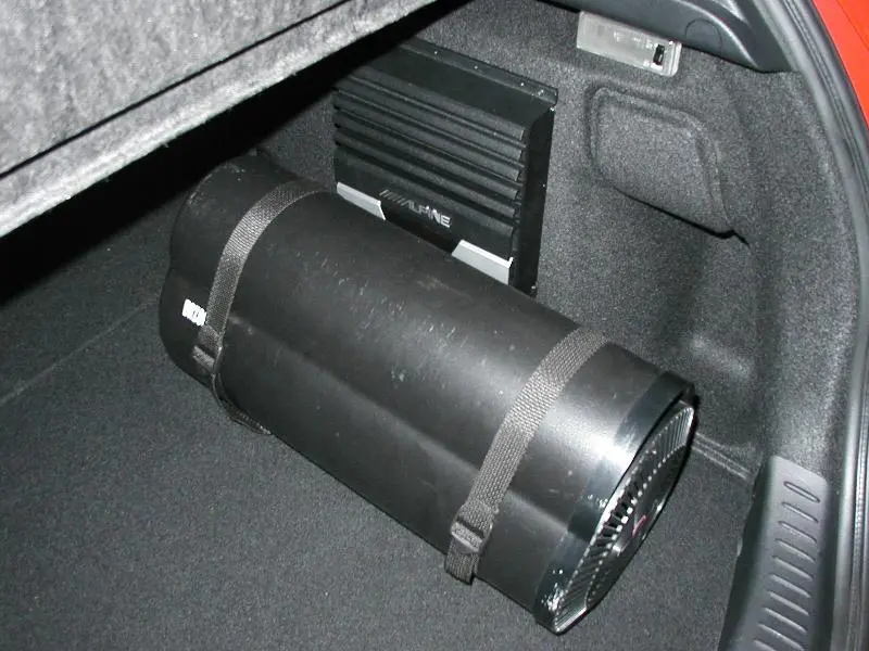

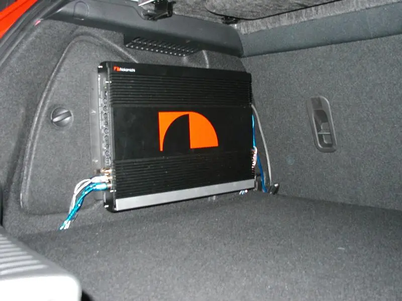

Amps: Nakamichi 4-channel powering fronts and rears with HP crossover at 100 Hz and Alpine M-300 monoblock powering Bazooka RS-8 dvc sub, crossover set at 100Hz LP.
Sub: Bazooka dvc RS-8
Wiring: 4 gauge power wire split into two 8 gauge with power and distribution blocks hidden and screwed into plastic "cove" under trunk floor cover.

HU illumination showing both blue and red posibilities, as well as with camera flash, but night pics do not do it justice in real life.

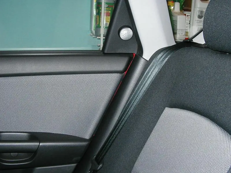

Front and rear tweeters mounted to sail panels. Woofers are in stock locations with crossovers hidden in doors with double sided industrial tape and covered loosely to protect wire, etc. from water/dirt.
Amps and sub in trunk. What a PITA that was to mount that 4-channel!

to bad about the left side amp covering the jack hole... would have almost thought on the back of the seat would have been better??? why you go with 6x8 and not a 6.5?? over all nicely done!! any sound deadening?
I needed a flat surface for cargo to transport anything with the back seats folded flat, so mounting the amps to the back of the seat would have defeated this. I can easily remove/move the sub, so that is no problem if ever needed. Yeah, that was a major pain figuring out a way to mount the amp over that jack opening. Had to put some wood in there, mounted to the frame and then mount the amp to that with some very long screws. I always carry a small tool kit, so if needed I can remove the two screws and easily flip the amp forward to get to the jack.

Are you not afraid those rear tweeters will destroy the hearing of anyone sitting back there?
LOL! Yeah, they're pretty close to ear level. I'll just have to turn it down if I have passengers. I've sat back there just to see how it sounds. It's not so bad with the nice clean power I have, even turned up quite loud. With a crappy stock system or with any distortion, I'm sure it would be very harsh. I actually have the treble at -2 on the HU which blends nicely.
what the hell happen to the sub?! it looks like you rolled it around in the gravel before you instaled it? over all, not a bad install.
It was sitting in the closet for 6 months between vehicles. It was in mint condition before that, but I had it set vertically against the wall which had textured paint and unfortuantely it scraped along that a few times when I was moving stuff around. I'm pretty anal when it comes to that stuff, so I was not all that happy about it. At least it just sits in the trunk. Thanks for the comment!

In your pics the color doesn't even match the car's stock.
Like I said, the camera does not always depict what it looks like in person. The blue on the Alpine matches the blue/violet of the speedo/tach very closely, but is much brighter and shows up almost white on the pics. The red on the HU matches exactly with the stock lights. And I never claimed to be a professional, nor was I bragging. I was just showing some pics in case anyone wanted to see the results. I am happy with the sound and appearance based on my requirements. Others may have more or less requirements and can make those adjustments on their own cars.
