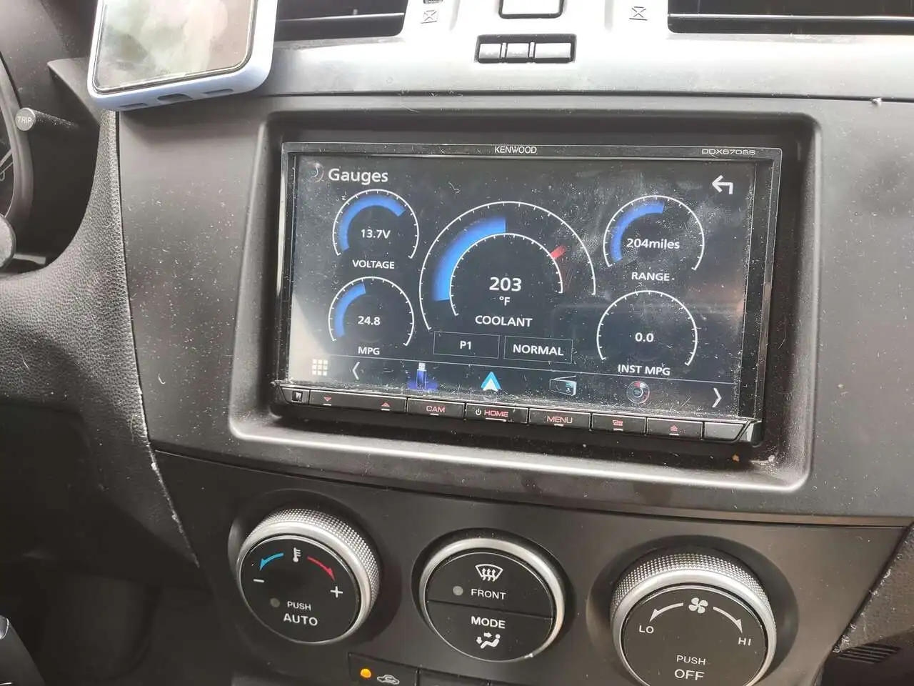

As far as gauges go, I put a Kenwood DDX8706S stereo with an iDataLink Maestro RR interface module in our 2012. That gives us gauges right on the face of the radio, including water temp and voltage! The only thing I wanted that it doesn't display is oil pressure. I definitely would have liked to see that.

With my setup, I get all of the trip functions like MPG and distance to empty right on the radio.
