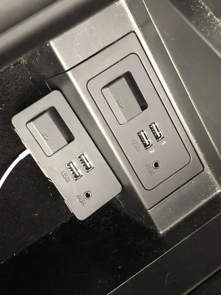

So I bought the new USB interface and cables on tbfocus - they arrived yesterday and we installed them today. Very straight forward (the CMU is located UNDER the screen, not behind the glovebox) and I'm now charging much faster than I was before.
Now I just have to wait for v70 of the software and update it at home.

New USB interface (installed) vs old USB interface (sitting in the console) for comparison. Sorry for it being so dirty, didn't get a chance to clean it after we installed everything..
Nice! I might end up with the DIY project too if Mazda keeps dragging their feet.

How did you get to the CMU?
two bolts behind the infotainment display (they're under a little plastic cap that is colored to look like the leather trim). Once those bolts are out, carefully pry around the trim and pull up on the screen; it will pop out. The metal "computer" looking thing under the screen is the CMU.
There are two bolts that hold it in on either side - undo those bolts and it will slide right out. The connectors are on the back of the CMU.
Just to be clear, you just have the module installed (faster charging), the AA/ AC functionality is not yet rolled into your system, correct?
Also, will swapping this connector void your warranty?

That's correct. I can confim the charging works significantly better after the install.
I have no idea about the warranty but I'm already outside of the bumper to bumper (shrug)
