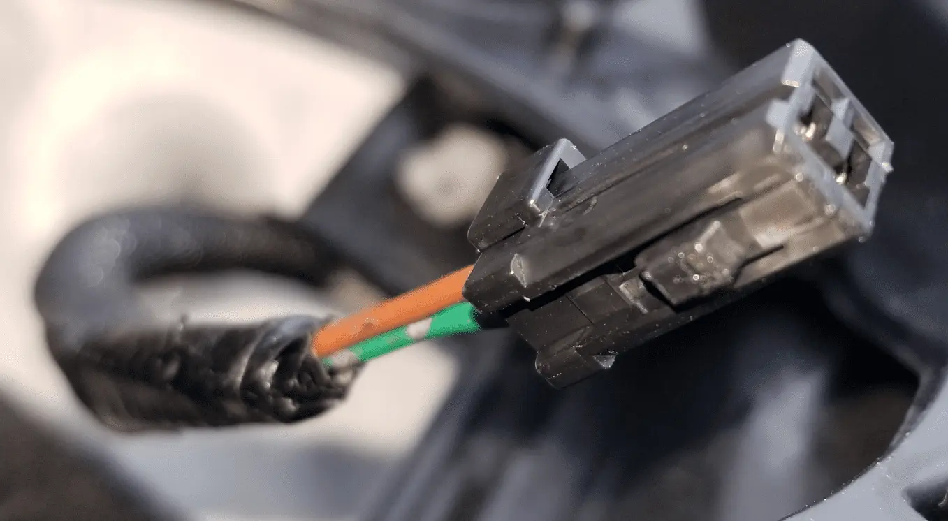

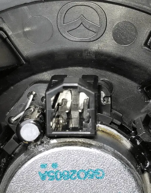

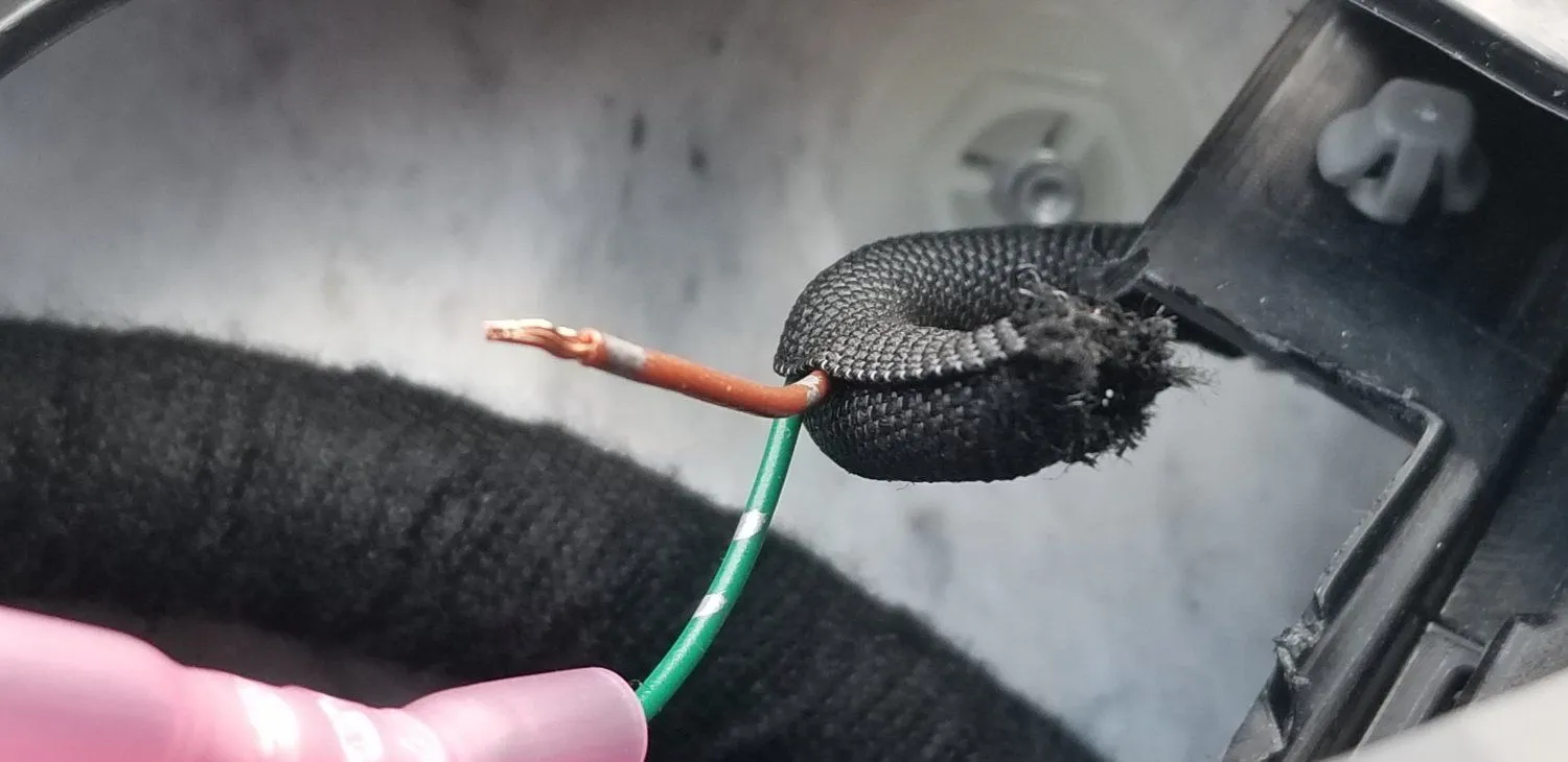

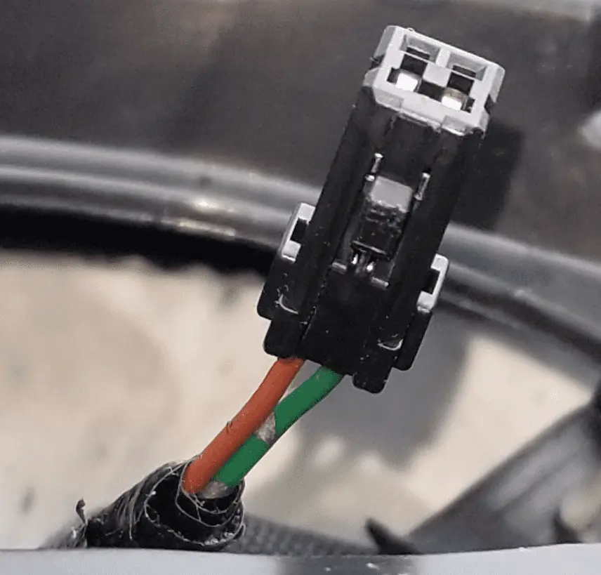

Appreciate all of the support. I actually purchased the https://www.amazon.com/dp/ (commissions earned) last night and also the https://www.amazon.com/dp/ (commissions earned) adapter which should be arriving tomorrow. An hour ago, I took apart the dash speaker out of the enclosure and I think even if I purchased the 7901 or the 7902, it would not be compatible with the Mazda dash connectors because the bottom portion of the female connector is flat with no line going through the middle of it. So I'm thinking that the only way to make this work would be to trim off both connectors (OEM + Metra 7901) and snip off 0.2 - 0.4 inches of wire and exposing the copper on both cables (OEM + Metra 7901), then use butt slice wrap and crimp it.

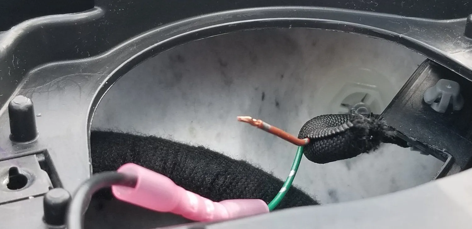

I'm not sure if this would be the best way to approach it but it seems to be a good solution. Also, after disconnecting the dash speaker, I noticed that there are two cables (brown and green) and this makes it very hard to determine which one is positive or negative. Not sure if you would be able to help but if you can, that would be greatly appreciated. Please see the pictures below:

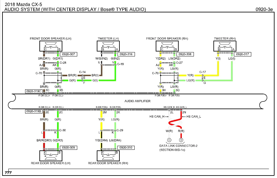

I did look through some electrical wiring diagrams included in your post and some online but there was no mention of the dash speakers. However, for the front door speaker/tweeter wiring, it indicates that brown is positive and green is negative. I could be wrong but here's what I'm looking at:

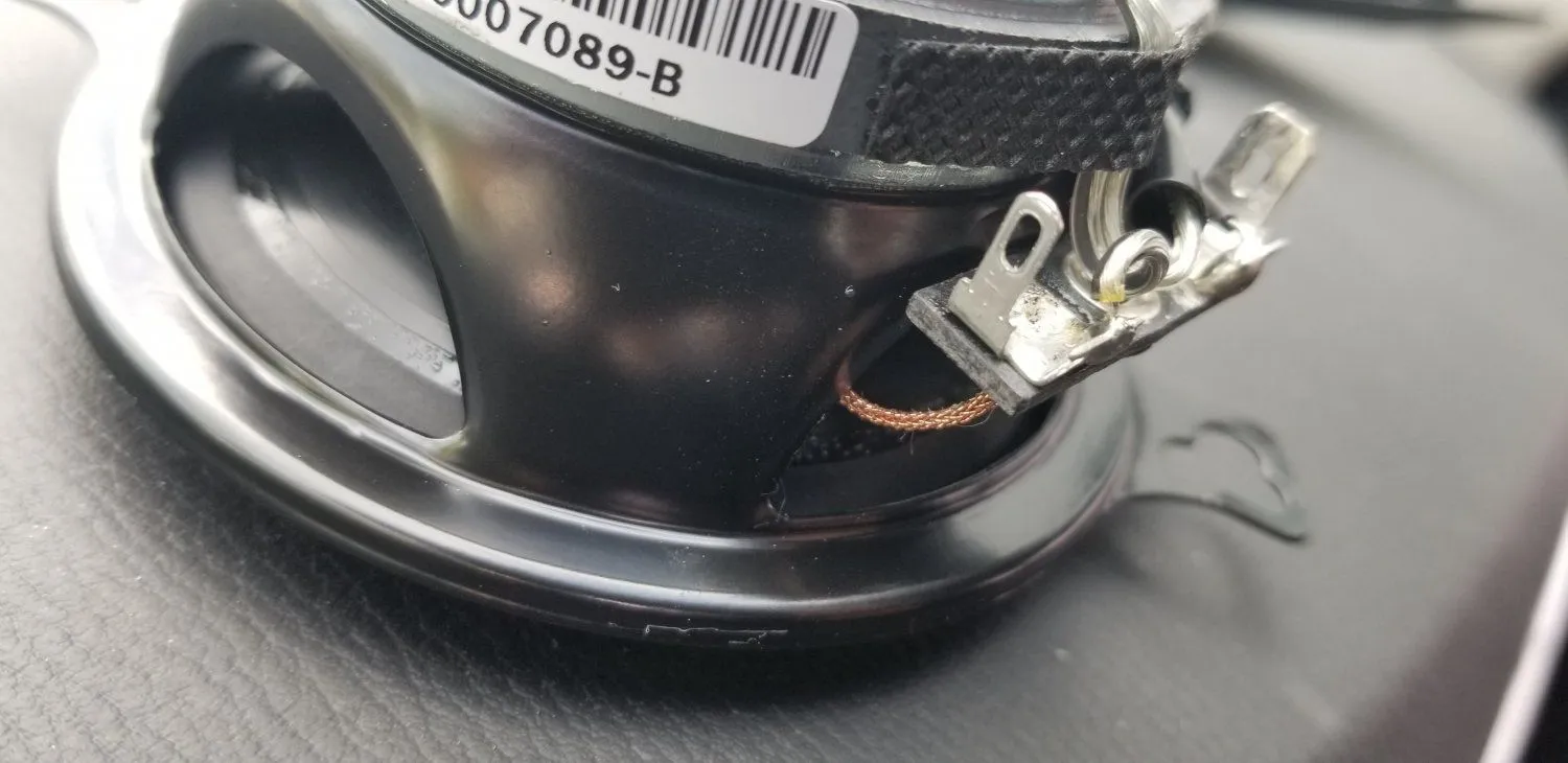

Driver dash speaker:
Dash speaker connector
OEM speaker Input:
Side view:
Top View:

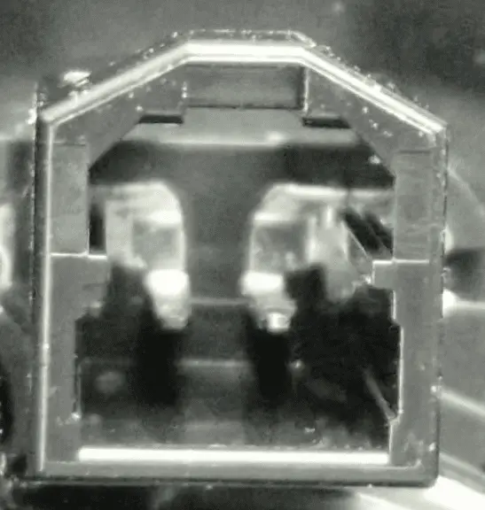

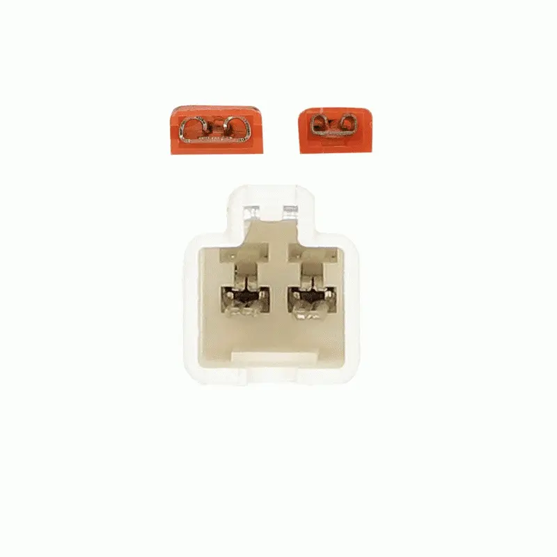

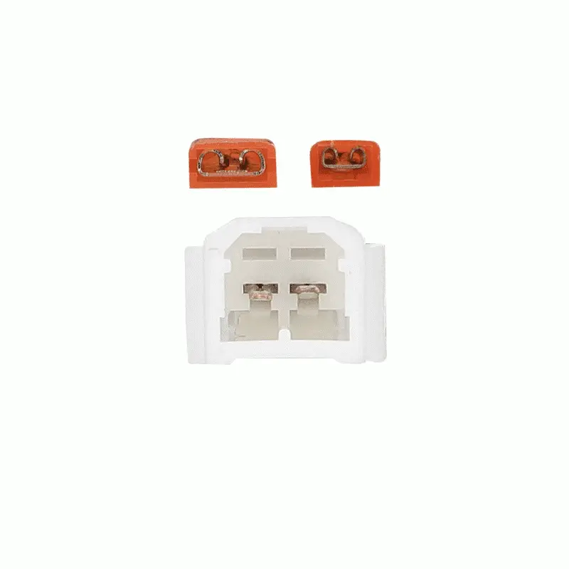

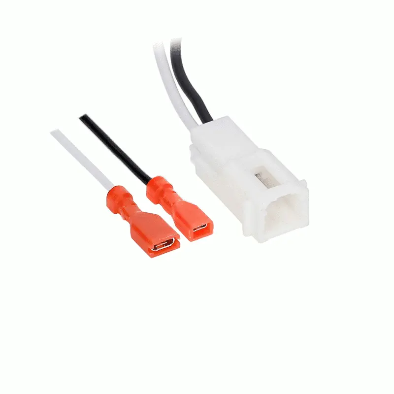

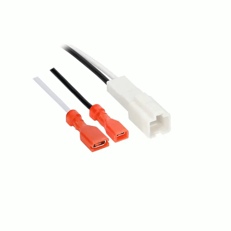

Here are some pictures of the Metra Connectors. The top portion of the 7902 looks pretty much identical to the Mazda speaker connector except for the ridge on the bottom. I'm thinking maybe I could order the 7902 and sand off the ridge, should work I suppose?
Metra 72-7901
72-7902

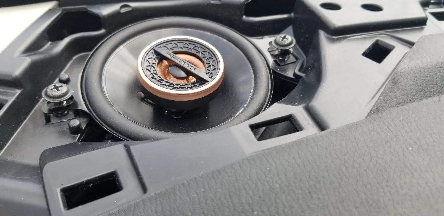

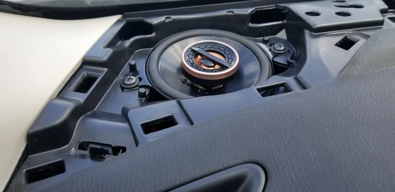

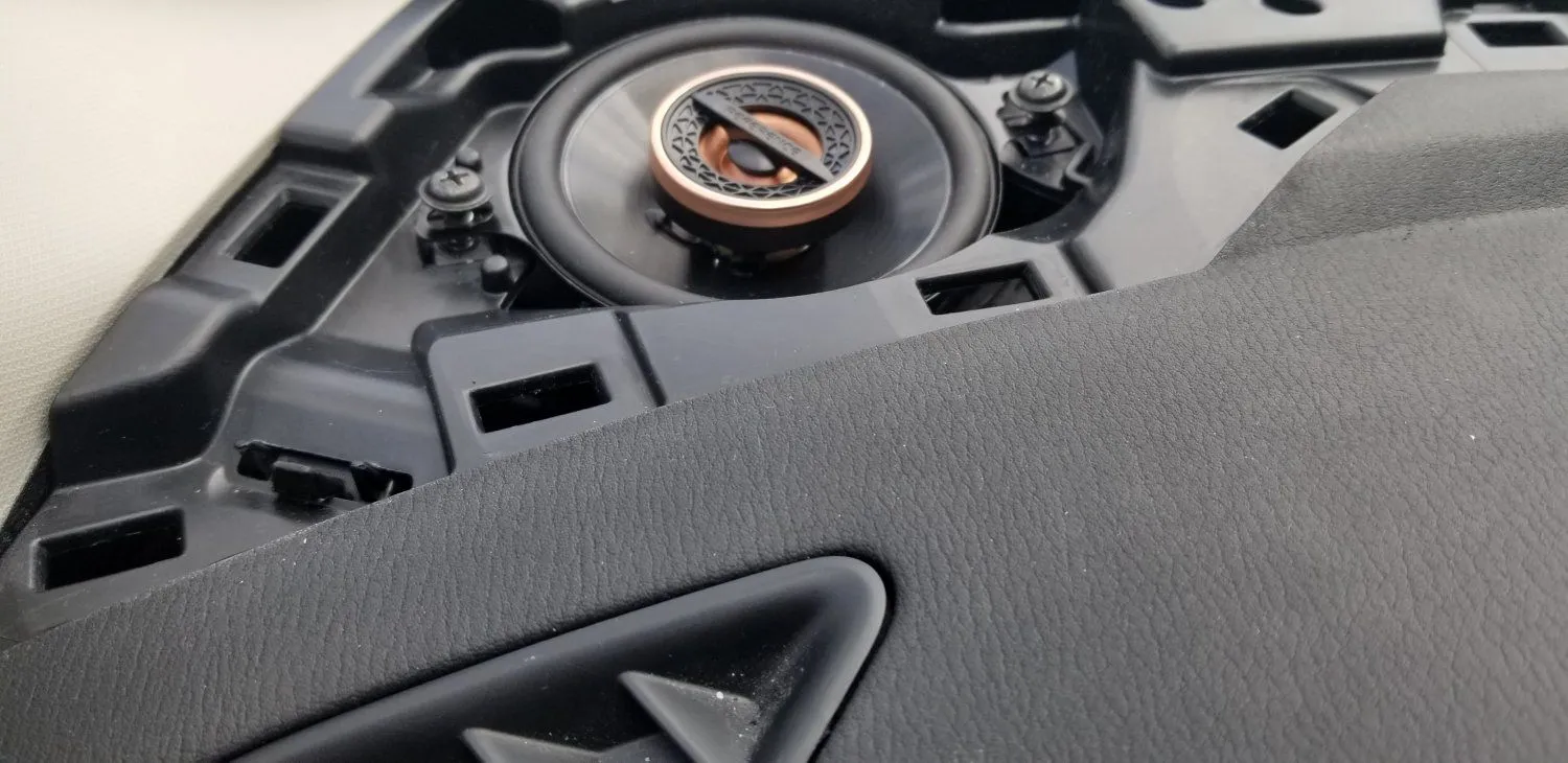

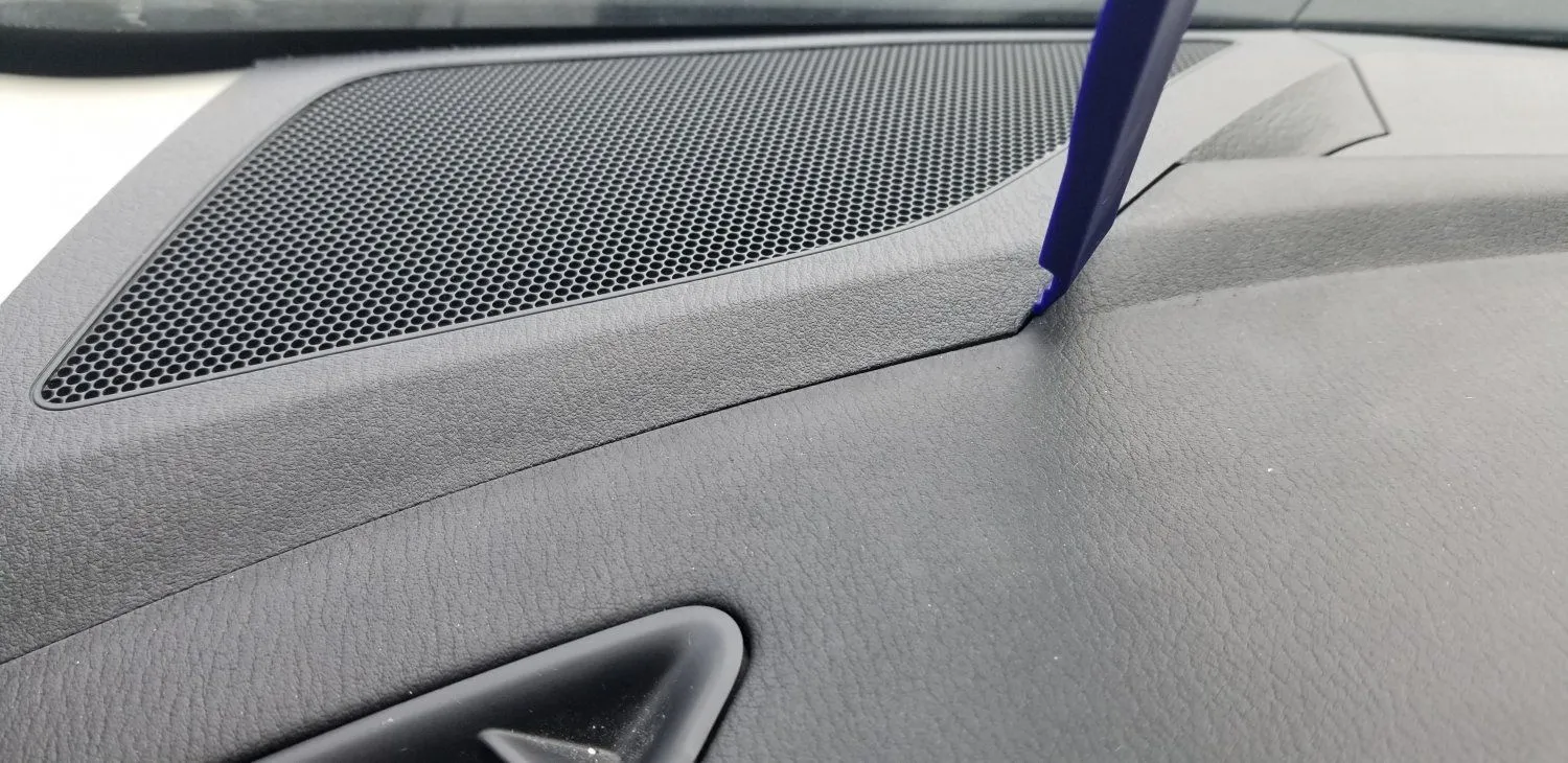

Update: I installed the Infinity Reference REF-3032CFX dash speakers today. Overall, it wasn't that hard except the fact that the OEM wiring is extremely tight and there's little to no room for error. I made a few mistakes and chopped off more wiring than I should have but it ended up working still. Another mistake that I made was with the butt connectors which was most likely from being lazy or careless but I had to redo 1-2 wires on the passenger side. For the Metra wiring harness that I received, 1/2 of the pairs of adapters I received had a crappy crimp for the speaker side connector and it made it slightly difficult to install.
Also, for the driver side, the dash speaker was slightly tight and I had to pretty much push it in and hold it while using one hand to start the screw.
Overall, I think that these new speakers sound a lot more clear than the OEM ones but it still seems to be missing something and I think that would be bass.
Note (Polarity):
Driver (Dash):
Green wire is negative (-) and the brown wire is positive (+).
Passenger (Dash): Green wire is negative (-) and the yellow/black wire is positive (+).

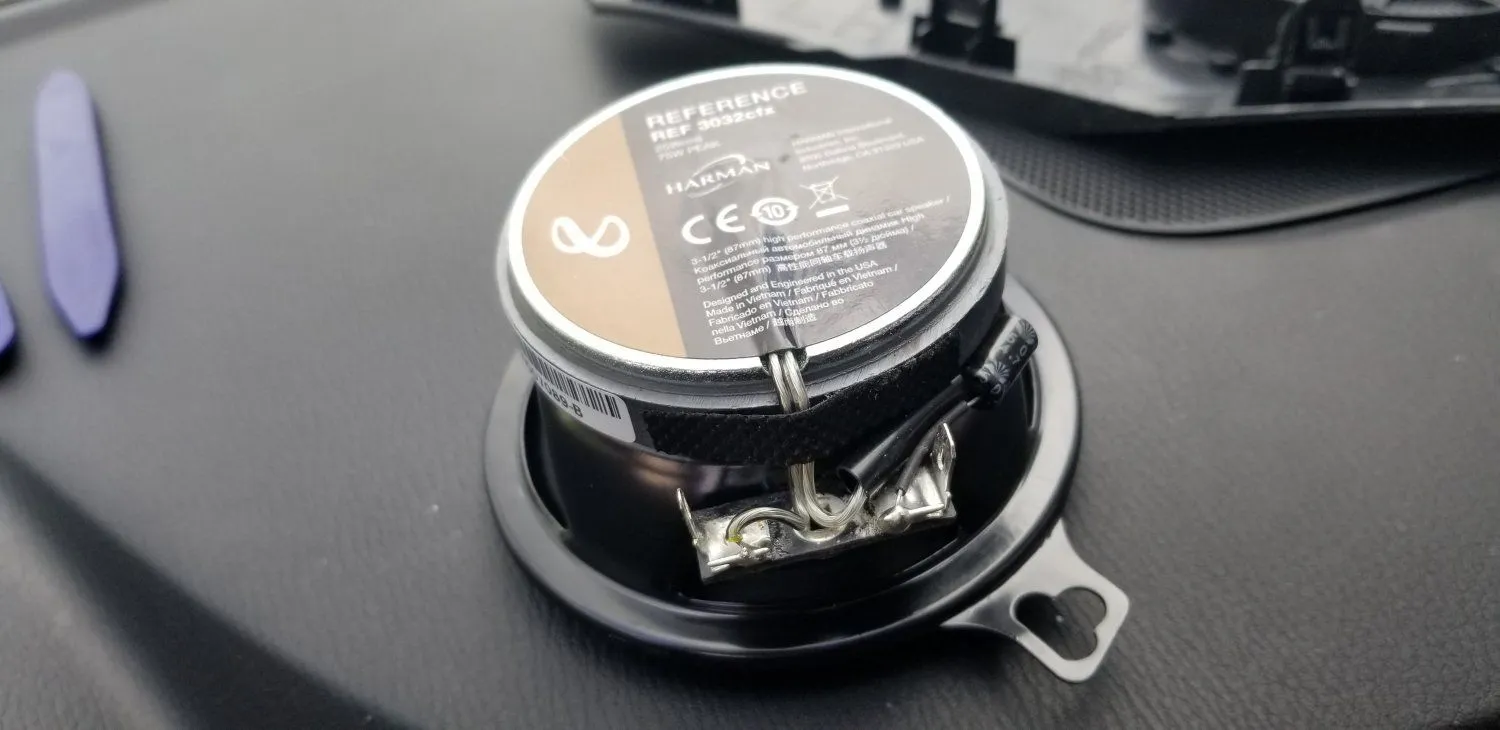

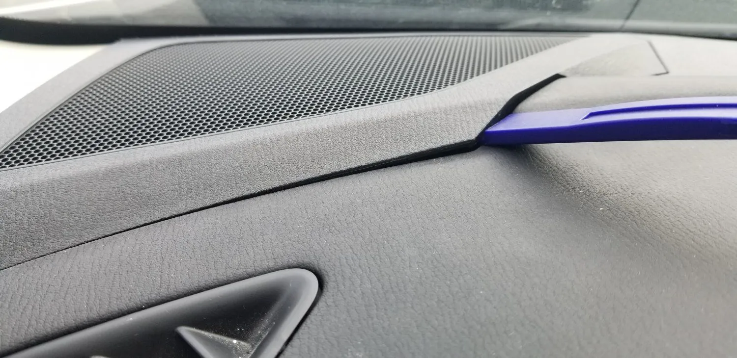

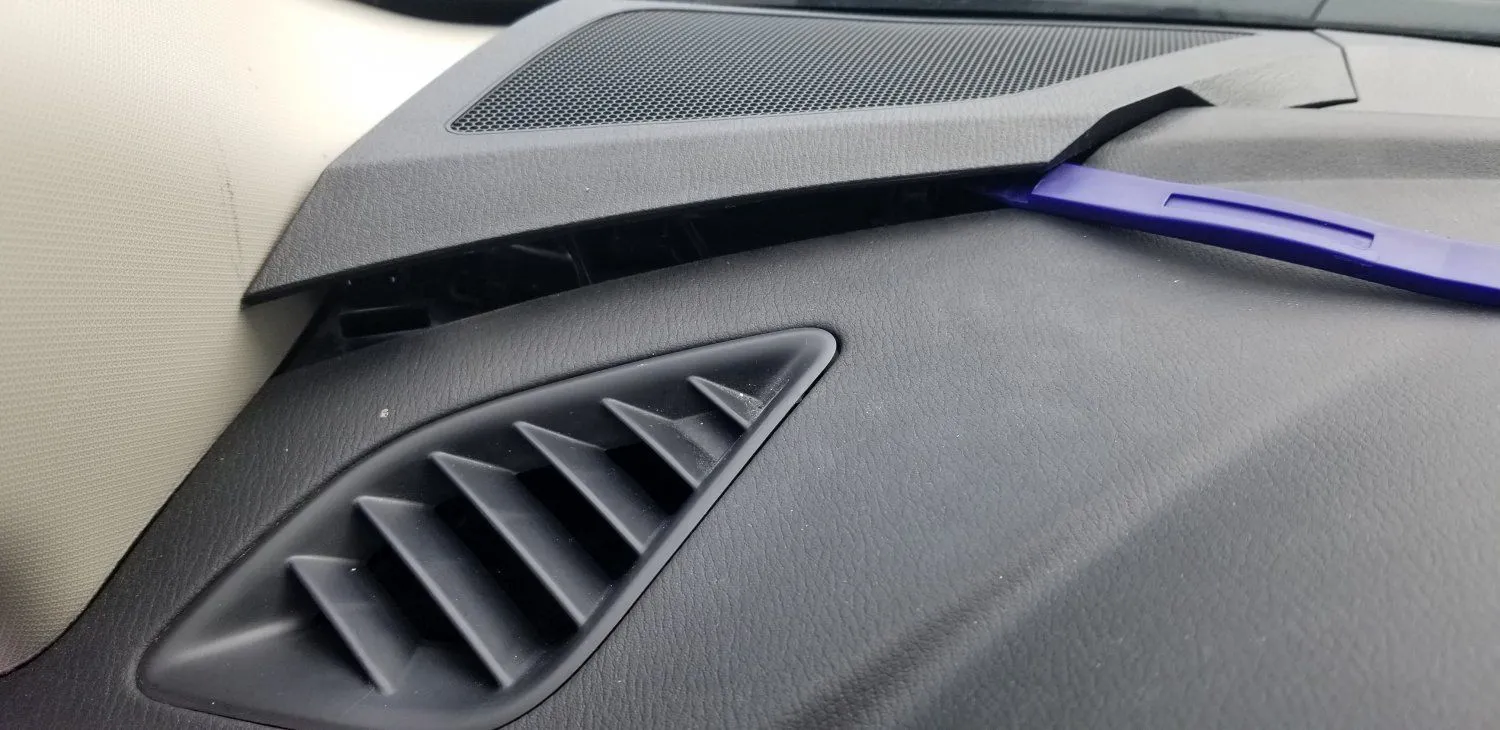

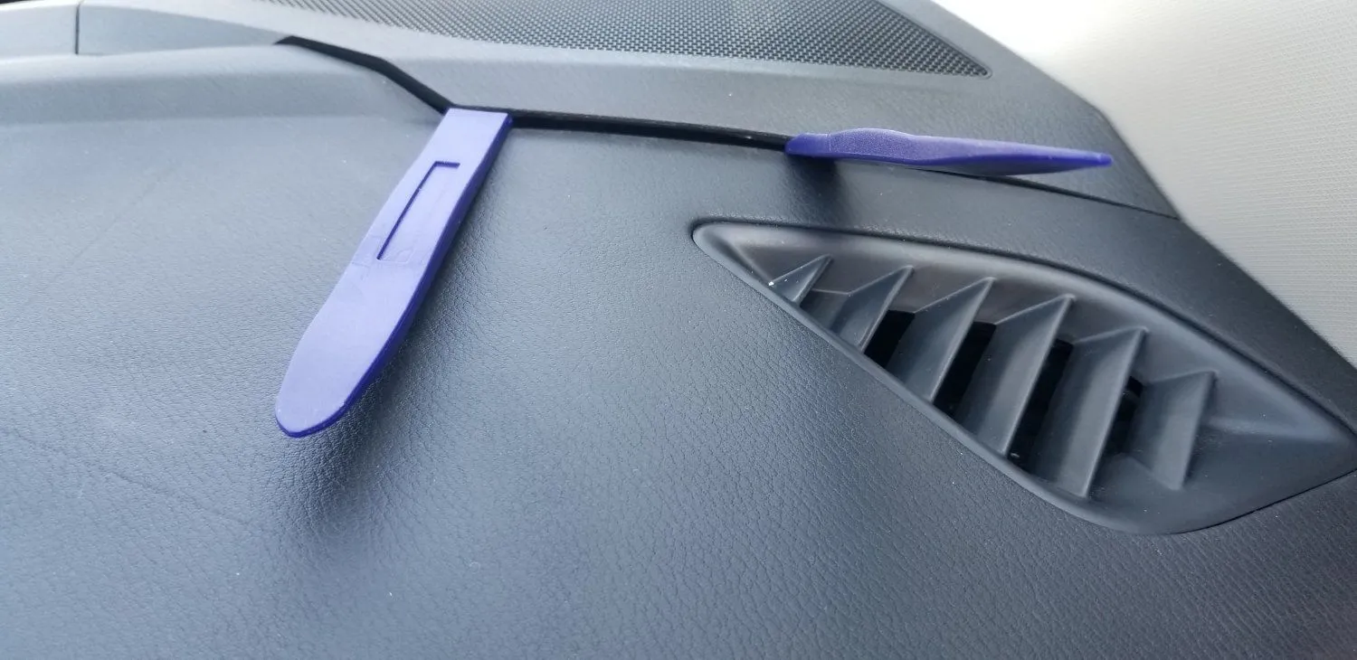

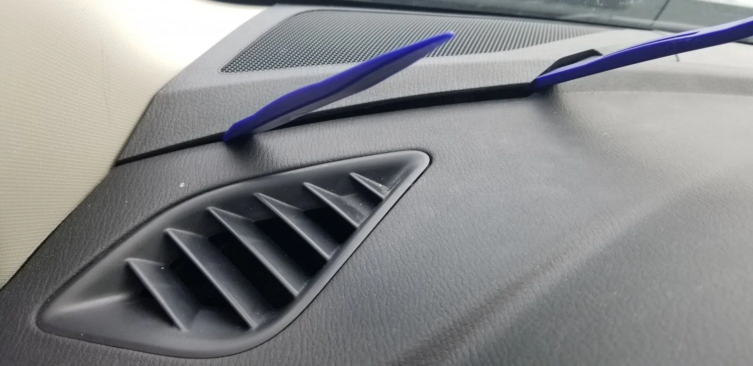

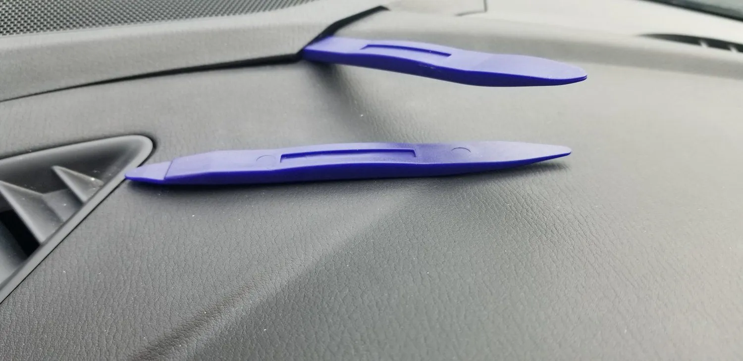

Here are some pictures of the tool I used to pry the dash cover open and also the speaker itself. I dun goofed a bit, used the heat gun and actually melted the plastic a little bit. I wish I bought the adapter for the heat gun that would focus the heat on one section at a time but I didn't and it made things a lot harder since the speaker corner is very tight and there's little space to do anything. Also, for the butt connectors, get them from Home Depot and not Harbor Freight like I did, they're very poor quality.

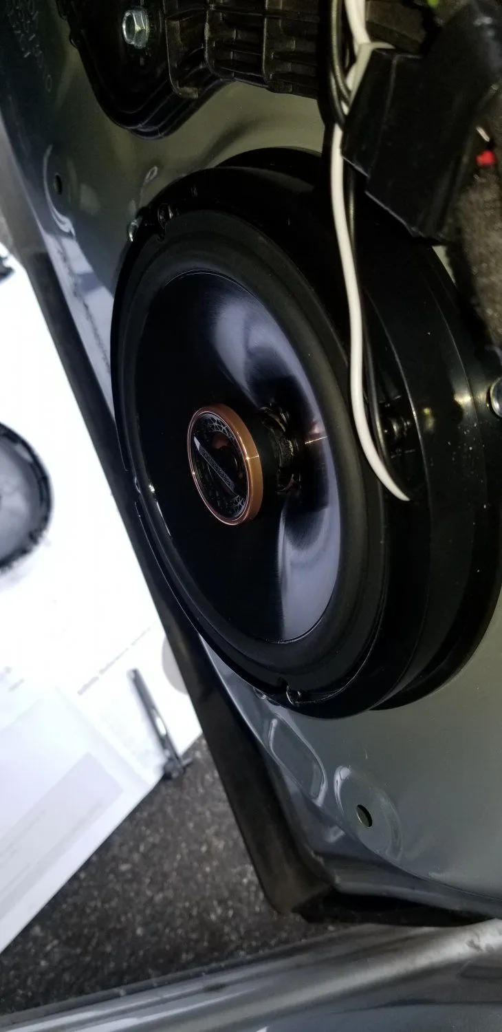

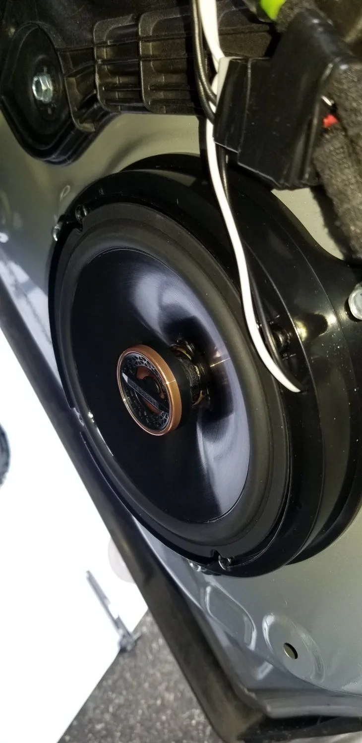

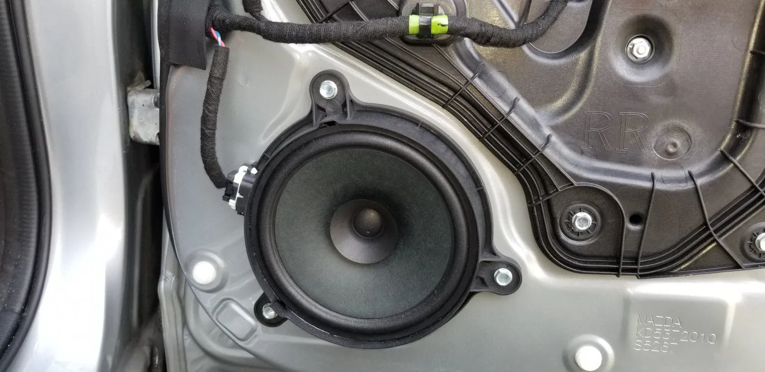

I finished upgrading all (6) speakers a while ago, here are the items that I've purchased and installed. I realize that I did not need an amplifier at all. Also, using the AUX cord made everything way better than bluetooth but it's impractical :)
  1. Dash: Infinity Reference REF-3032CFX
  2. Front/Rear: Infinity REF6532EX
  3. Front/Rear Speaker Harness Adapters: Metra Electronics 72-5602
  4. Front Speaker Mounting Bracket: Metra 82-7501
  5. Rear Speaker Mounting Bracket: American International NSB710
For the rear speakers, there is no hole/cutout in the center portion of the adapter housing so you'll most likely need to fold the Metra harness into the slit of the adapter. Everything ended up working perfectly and the sound is way better (bass and vocals).
