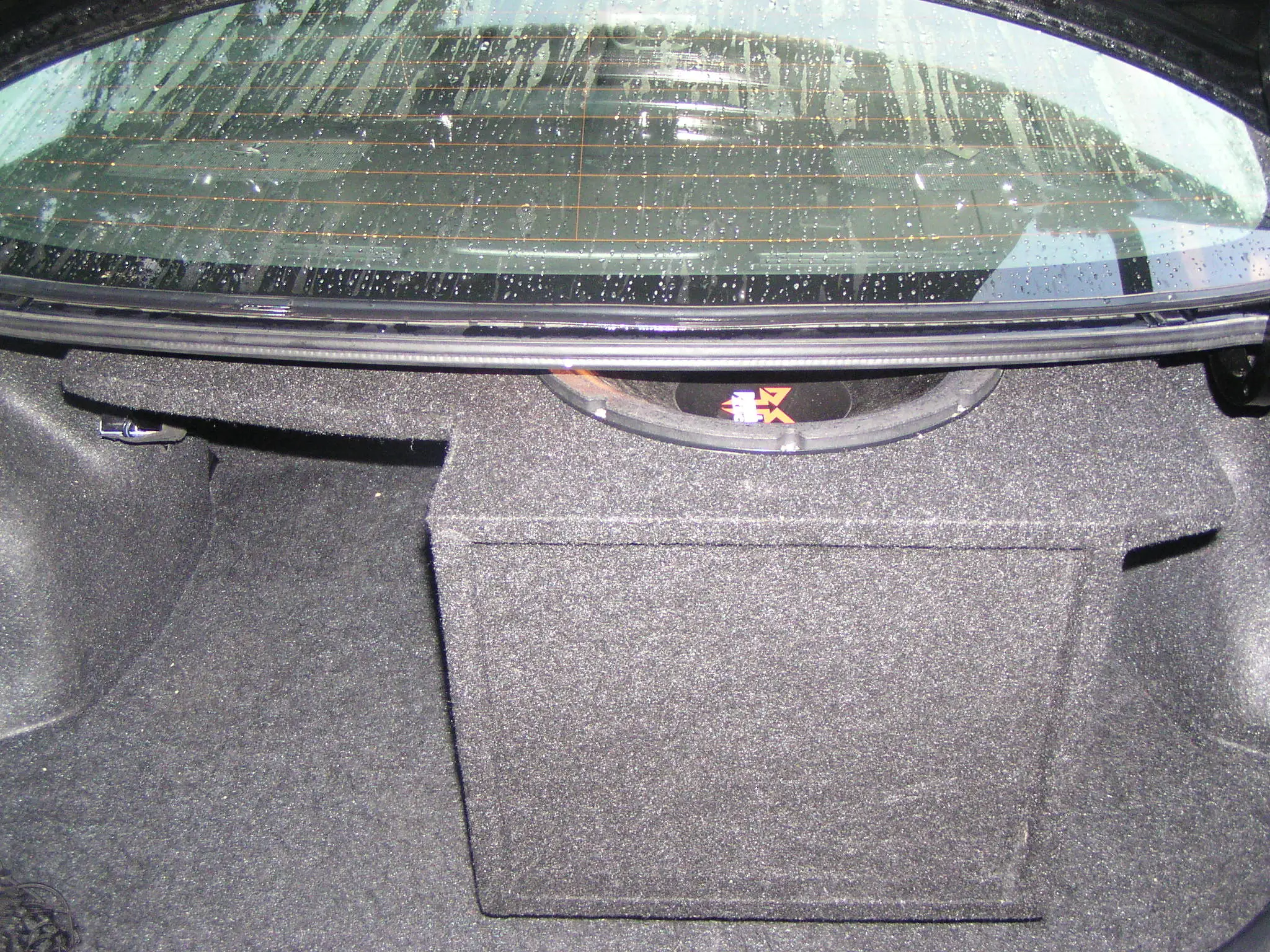

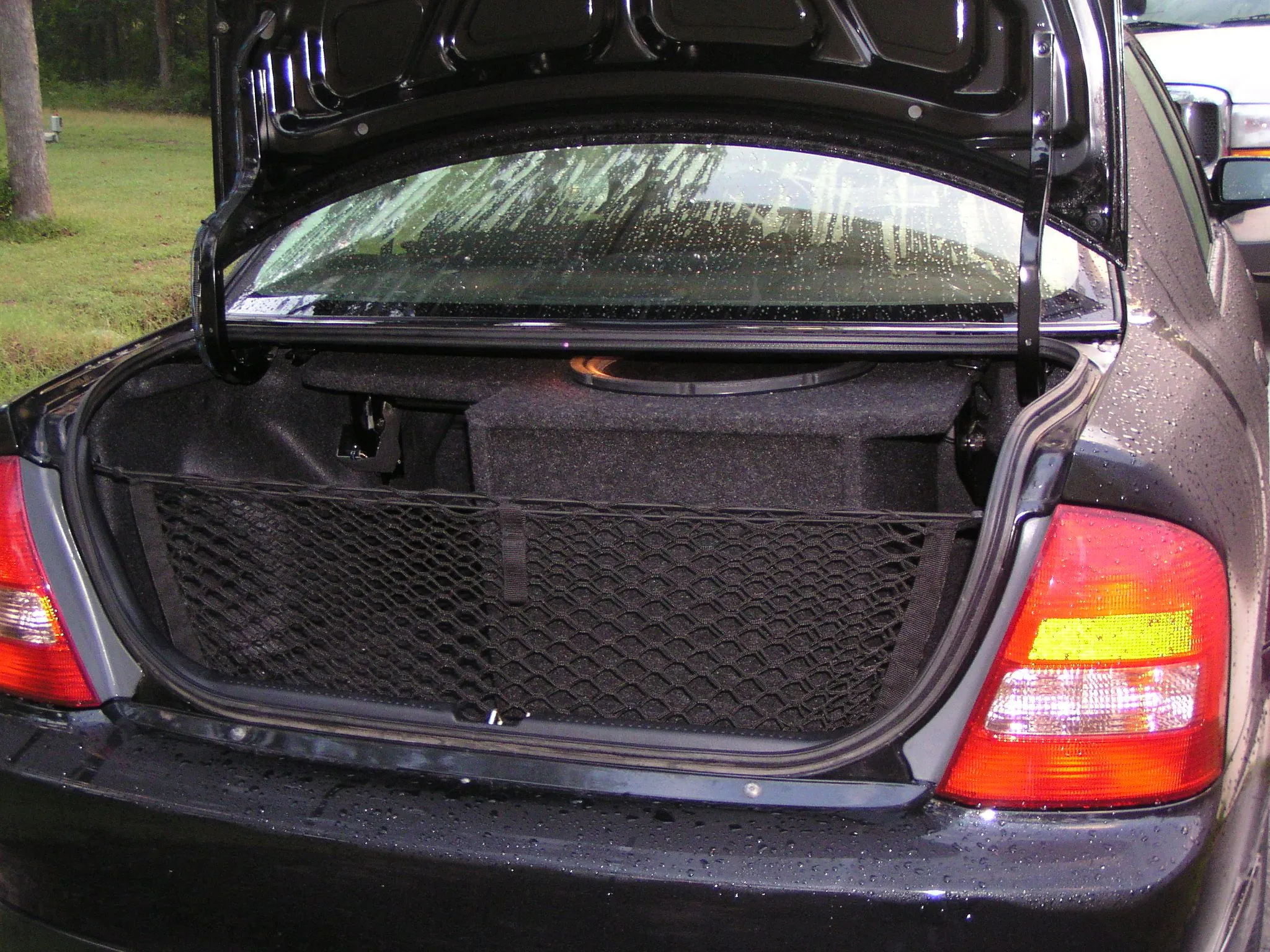

I am running a Rockford Fosgate rfp2415 15" off the stock amp in the stock location upside down. I used the stock MSP sub mount as a template to make the new enclosure. No over heating issues.
The new box is 2.25 ft^3 and I have no filler in it. The sub is pointed up throught the rear deck and pumps a massive amount of air in tha cab. You can actually feel the A/C get pushed back by your head when the sub hits. (naughty)
I designed the box so that it hangs from stock hangers yet leaves enough room to get the spare tire out if needed without removeing the sub box. I just ran an autox with it and it did great! So I am one happy thumpin' camper. If theres any interest I can post pics.
Adding pics: Warning large file! almost 800kB
