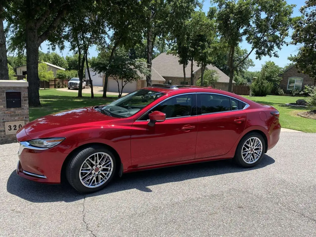

As promised, guys. New tires/rims. Working like a champ. The ride is incredible with the larger series sidewall. And looks pretty doggone good.

Tires fit perfectly and speedometer is spot on correct. The additional sidewall flex is remarkable on ride quality. And there is no noticeable difference in steering. If anything, it feels more responsive. Maybe the new Pirelli’s get some credit? Really quiet on highway. Noticeably quieter than my OEM Falken’s.
These rims are manufactured to fit a Mazda6 insomuch that these share common dimensions and fitment of the old rims: bolt pattern, same 40 offset, 8” wide, and 18” diameter. Hub bore on new wheels was 71,3. OEM Mazda wheels are 67.1. Simple concentric rings squared that away with a nice snug grip.
Hope this helps. BTW, I found a center cap sticker logo to put on the center caps. 66mm. About $9.95 for the set. My other caps were a 58mm. I will attach a pic of the covers. Just a holdover emblem from my tours in Vietnam in the 60’s & 70’s. Should have them in 7-10 days.

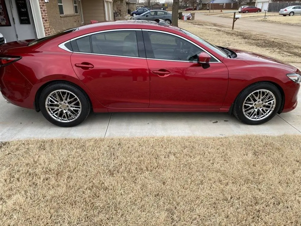

I opted for 18” rims, 8” width. Mounted 225/55R/18 Pirelli Scorpion A/S rubber. Car handles like a dream. Ride is smoother due to 55R’s sidewall flex as opposed to Mazda’s 45R offerings from the factory. With the new rims, everything looks great. IMO, LOL YMMV
