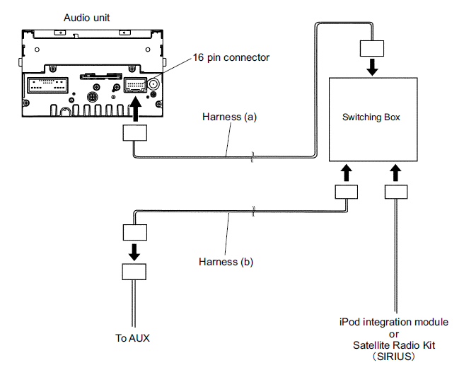

Anyone installed or watched installation of switching box?
palooka23
I was wondering what is involved. Is it worth the dealer doing the work?

Here are the ones relevant to switch box installation...
-Jeff
  • IPod_Switch_Box_(CX9)_.pdf
  • Ipod_Integration_Module_(CX9)_.pdf
  • Satellite_Radio_Install_(CX9).pdf
-Jeff

I've got a 2007 CX-9 with factory installed Navi and Sirius. Will this device work to activate the AUX jack in my center glove box?
I have the same scenario - Navi and Sirius for a 2007 CX-9. I have the aux phono plug in the center console and would like to activate it. Has the part number for the switch changed or is it still TD13-79-CFZ?
Craig
I've read that if you have both sirius and navi, the switchbox won't work?? I'd love to hear from anyone with this configuration that has acutally got it working before I spend $120. BTW, I think the P/N is an old one. Check this link, they talk about a new P/N.
http://www.mazdaparts.org/audio.html
Its too bad that we can't use Harness (b) for the iPod integration module. Does anyone know how to use both a Sirius receiver with an iPod integration module?
