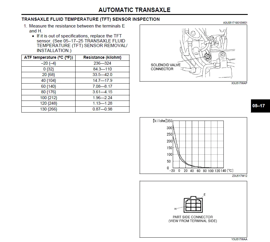

BUT my question is how did you fix it or have it fixed.
Ive changed the sensors twice... pretty sure its all grounded. but is there a way to actually test it
According to the service manual, the test for proper transmission fluid sensor function is to measure the resistance across two of the pins at various temperatures. See the attached image file:
