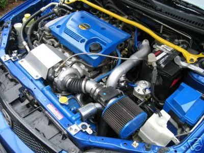

what turbo u have with your kit? Garrett T3? cause that's what i have. Also, i have the Turbo XS BOV, ACT Clutch, Indigo Flywheel, a Short Throw shifter. Here is a pic. of the turbo setup. Looks nice and neat right?
That's not a BEGi.. :rolleyes: A great kit nonetheless that I have seen installed in person..... it's ok to love your performance mods, but damn, you advertise whenever you get the chance. (rlaugh) You ARE the right guy for the job.... (poke)
